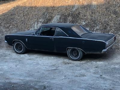

...I could have put a junkyard 318 in the car and it would look right at home.
Rich's car though...
It is a much nicer car so the bar is a LOT higher. The engine we pulled out ran great and actually looked decent. This mill will add 48 cubes, well over a point of compression, add lots of cam timing and weigh maybe 30-35 lbs less. It isn't in the plan to dyno test the engine before installation but it sure would be cool to know what the flywheel HP numbers are. A junkyard fresh engine would look terribly out of place in this car. Even if it takes a couple efforts to get the paint looking right, that is what we will do.
