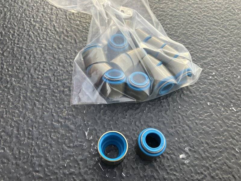

The heads needed new valve stem seals so I found some locally and brought them to my machinist. The Fel Pro gasket kits I’ve bought usually come with them but they are the umbrella type. Those fit stock heads with single springs but these heads came with dual springs or more accurately… single spring with a damper. These require these type:
.500 over the valve guide and a 3/8” valve stem.

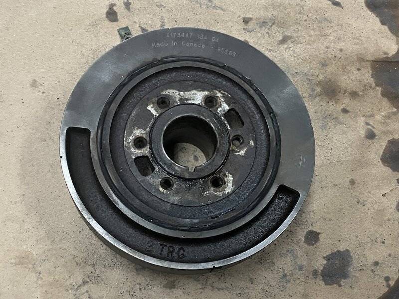

I did a cursory cleaning of the balancer…
It didn’t look OEM here:

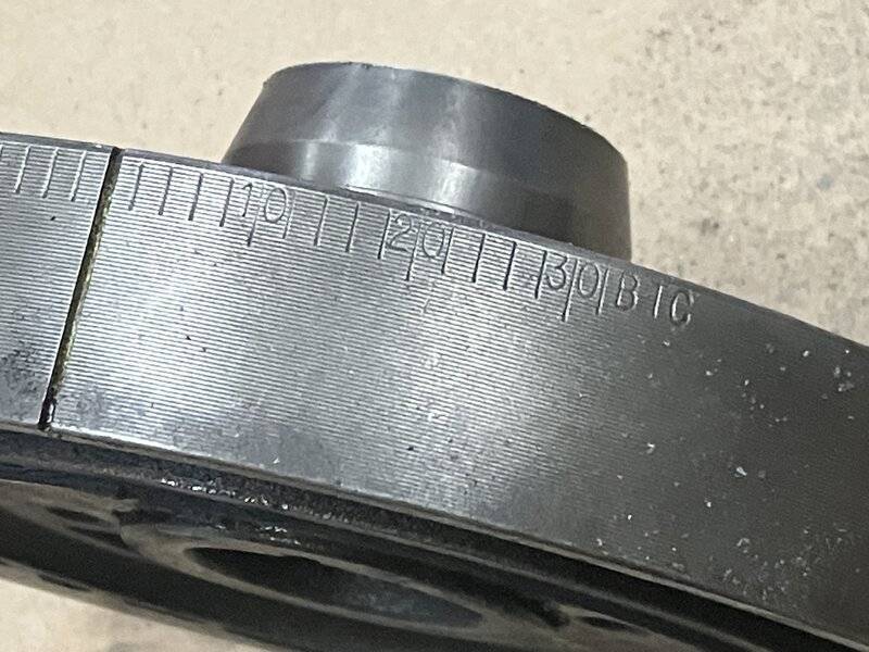

Then I looked at the timing grooves.
This director’s out to 32 degrees! I don’t think that I have seen that before on a stock balancer. None that I can recall had anything but a Single timing grooves with the tab on the timing cover.
Both the factory magnum dampers I have currently in my stash have the same timing marks. It’s rather normal.
This engine has a 1990 casting date, maybe they started adding the degree marks toward the end of the LA series? None of the older 318 balancers had this, none of the big blocks ones do either.

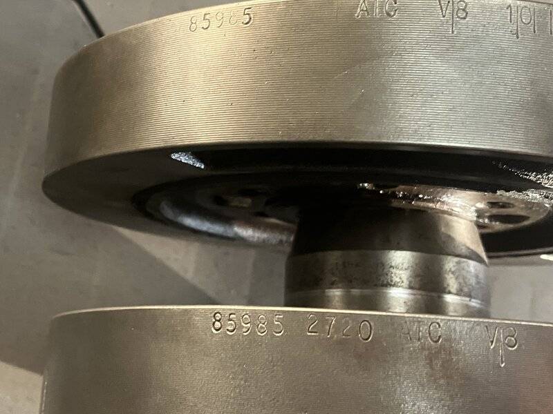

Well, surprise…..

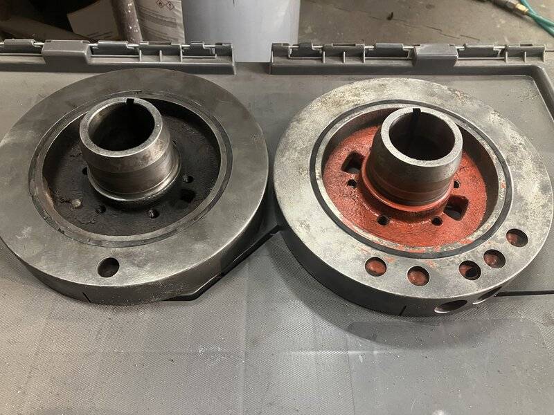

The one on the left is from my engine. The red one is from a 1991 Mopar Performance crate 360/380.
Same stamped in number, 85985.
Same pattern for the timing marks. The recess on the face is in the same spot.
But the “Magnum” has more holes drilled in it to make for the reduced amount of offset balance the Magnum has compared to the LA.
I’m seeing six more holes.
I wonder if one could weld those in to use this balancer on a 360?
Sure, I could buy a new one but I like to use and REpurpose stuff that I already have.
A 91 era MP short block would still be an LA. Mopar didn't even have the production 360 mag until 93
(As per your description of the engine that the 2nd damper came from)

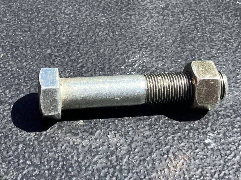

I’m trying to find a low dollar way to install the harmonic balancer. For big blocks, I use this:
It is a 3/4” bolt with 16 threads per inch. I crank it in until it bottoms out then spin the nut against a washer against the balancer and it sides into place.
The LA And Magnum blocks need a longer bolt. The threads need to be about 1 to 1 1/4” further up the shank. ACE hardware had nothing. I’m going to try a couple construction supply stores next.

I’m trying to find a low dollar way to install the harmonic balancer. For big blocks, I use this. It is a 3/4” bolt with 16 threads per inch. I crank it in until it bottoms out then spin the nut against a washer against the balancer and it sides into place.
I had the same problem on a slant. When I found a 3/4-16 bolt long enough, the threads were only about 1-1/2" (not enough) and the rest was smooth shank. I went to a really good fastener store and bought a piece of all-thread instead. The good news, it worked like a champ. The bad news, I had to buy a 36" piece to get any at all. I cut it into about 5-6 pieces, keeping one for myself and giving the rest away. I double nutted the back end to hold it still and ran down the balancer with another nut and washer.
Ha, ha…
“All thread”…. That is what I’ll be doing too. Grainger was the only place that had short in stock….12” for nine bucks. Of course it wasn’t in stock but they should have it by Monday. There was another place on the other side of town that had 36” sections for $26 but we didn’t need this today.
Your double nut idea would work but I might just weld a single nut to the end for the same result.

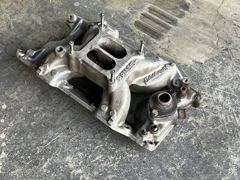

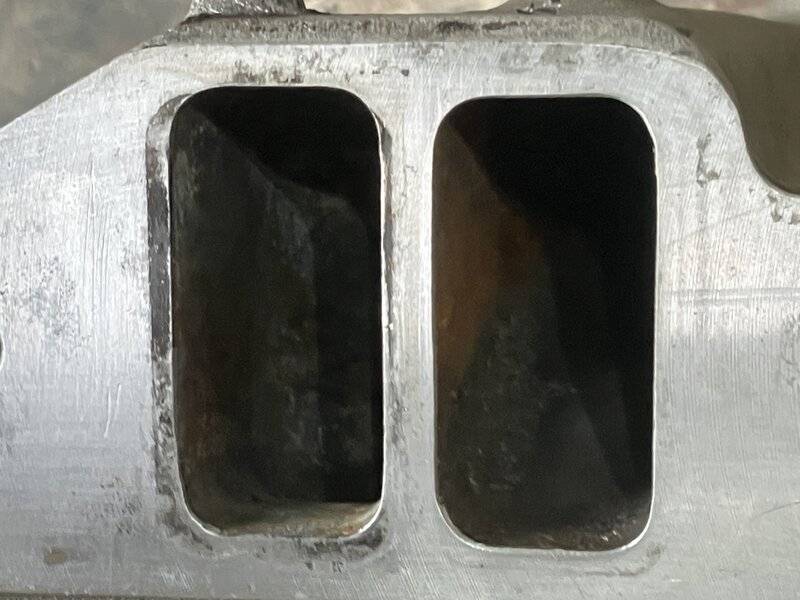

Onto The intake…. Edelbrock RPM AirGap, the popular choice for many:
This engine sat with water in it due to blowing both head gaskets.
The owner got pissed and just pulled this engine and let water sit in it.
He was not interested in show, he only cared about function so this engine was not kept clean when it ran. After he pulled it he cared even less.
Plenty of grunge along with orange, rusty looking grime inside.

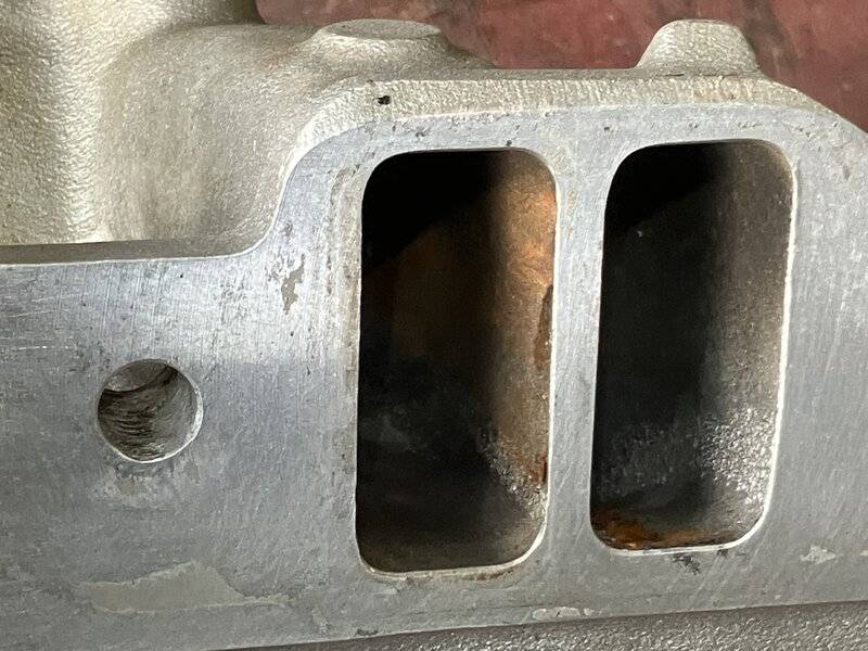

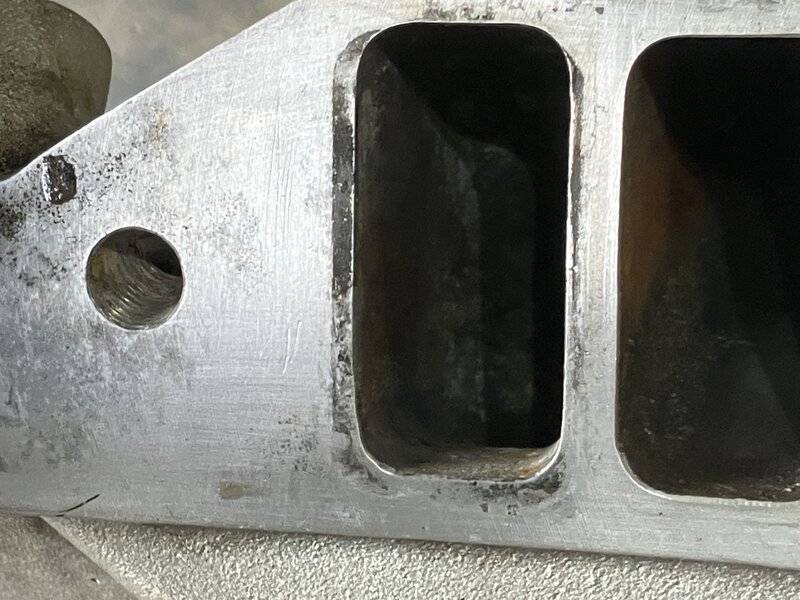

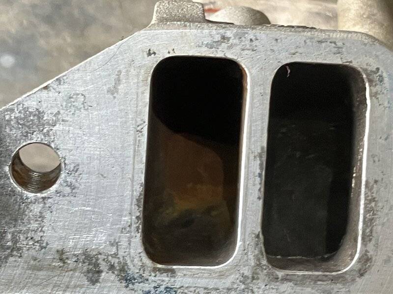

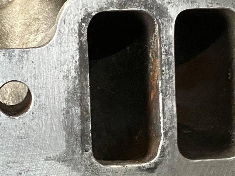

I don’t know how much it matters but check out the port alignment here…
This isn’t some chinesium knock off, this is an Edelbrock.
