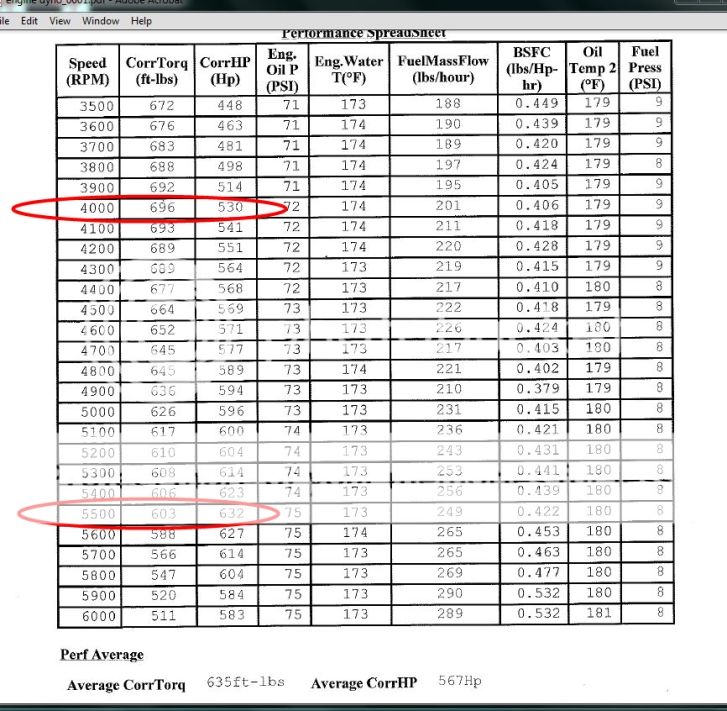

Hey, we just dyno'd a 505 on 91 octane with the Torker II and it made 657 HP. A better street manifold would be the RPM Performer as it made another 30 LB-FT of torque in the 3000 rpm range, but the Torker II will work okay, especially if you already own it.

We did a little work to the Torker II like raising the runners slightly and we are using Edelbrock RPM heads flowing 306cfm @ .600" lift.
