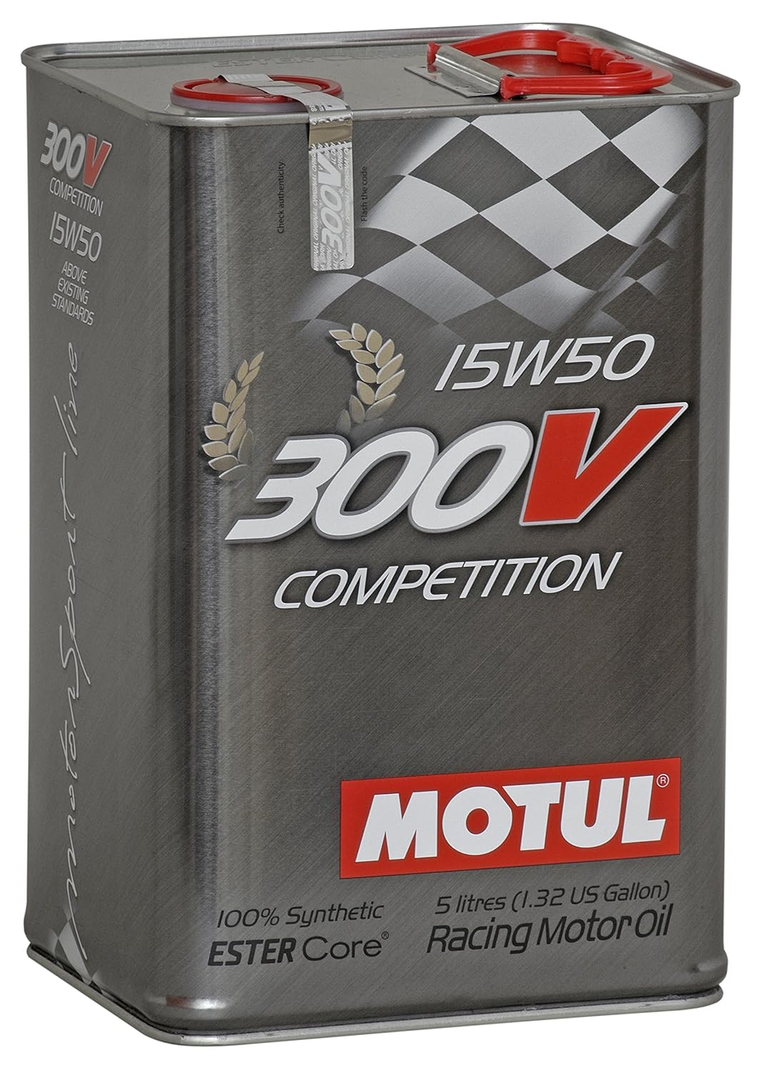

exactly. But at cold start its quite. With warming up it gets louder. Read yesterday about in deed about pushrod issues in the upper Cup area. changing them is way more inexpensive than changing lifters. I do flush the engine with ATF as someone said and fill thicker oil like Mobi1 10w50 or Motul 300v competion 15w50 thanks for that advise, have never thought about the viscosity.
if this is not giving the solution i change the lifter. from cheap to expensive... :)
Motul ?
Holy crap ! that cant be cheap !
I use Motul in my KTM but thats only 750ml every 7-9 rides depending on how many water crossings I do....
but it Looks so nice in the metal cans :) seriosly, it can't hurt. if it fixes the Problem - perfect. If not - I have super cool oil. Its around 120 USD for 10 Liters. Hope having some Discount in our local Auto parts store..
Its good stuff ! My bike definately shifts different if I use something else....
