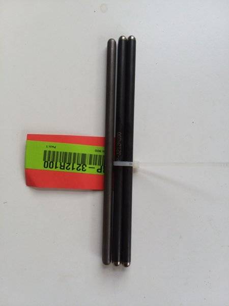

Here is a picture of the longer than stock push rods for an aluminum headed chev 350.
Stock push rod on left,
Longer 2 push rods on right to work with the aluminum heads. They were using the adjustable roller rockers with the longer push rods on the alum heads. This might be where the added length was needed to make up for the added height of the roller rocker ??? Lots of variables here.
Got to be careful not to touch the valves to the pistons with too much lift when making valve train alterations.
Another Possibility to check out.
