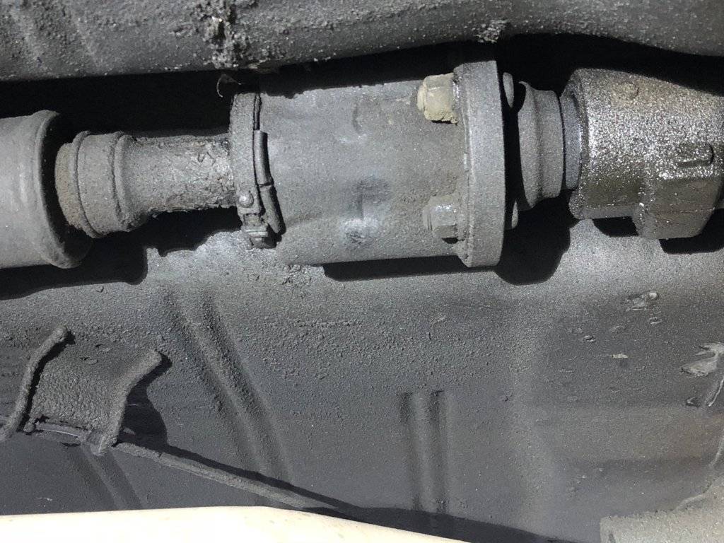

Yes sir I have already done that. In fact the level was fine. I dropped the cover and replaced the fluid too. Inside the diff looked fine. The noise is coming from this part here, Can I get a new one or what do I need to do to fix it?
Awesome! We are getting somewhere. Perhaps disassembling and inspecting it may be a good place to start.
Perhaps all it needs is cleaning and grease.
Never taken one apart before. Does the driveshaft need to be dropped to take it off? Is there a how to anywhere for this?
