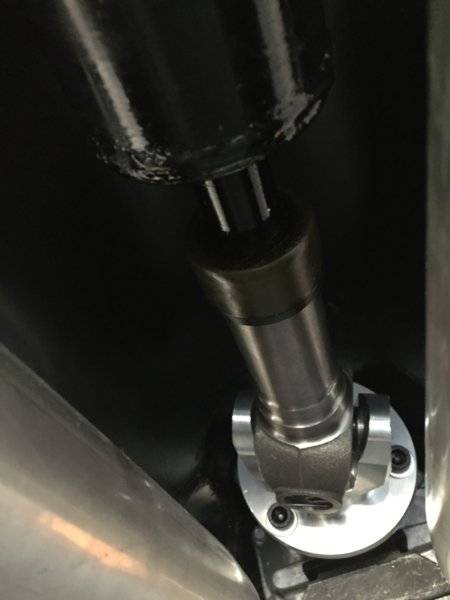

On plus side I got the drive shaft sorted out! Finally a win! The shaft will have to be a hybrid of old and new style fittings, or so I thought. With a bit of research turns out GM utilizes exact same coupling device for their rigs and in turn created a need for an adaptor! Picture attached, takes the funky European coupling and transforms it into antiquated American U joint technology! Add a slip joint and there ya are! Coolest thing ever! It is literally a perfect fit.
That’s exactly what I used.Works perfect!
So this evening I installed the drive shaft, had to abort last night as I did not have long enough M12 bolts. 1/2 American is close but just a bit big. The German tranny yoke was quite demanding with its bolt reqs. Suffice to say it is in. Funny how a single easy part to install can really motivate you. I got all jacked up putting in the drive shaft. Who knows I might even make this thing run yet.
Well from what I have seen that you have done so far Sublime one it will work. good job my friend.
Looking good sublime!I was really wondering what I was going to do with my driveshaft too and stumbled on the Sonnax adapter on a Chevy website.It is a nice piece and worked out great.A lot better than spending $1200 on a Driveshaftspecialty piece.Your build is coming along nicely
