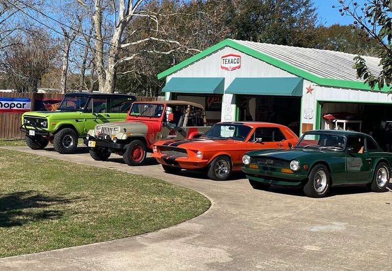

So, the Nifty50ees car get together is tonight, so getting the 67 Mustang ready to join those with like mindedness;)
One day the 63 Dart will join the line up :thumbsup:

How was the nifty 50’s gathering? Hope you had fun.
Well last nights cruise was dry and today it has yet to rain so kool April nights was a dry success this year .

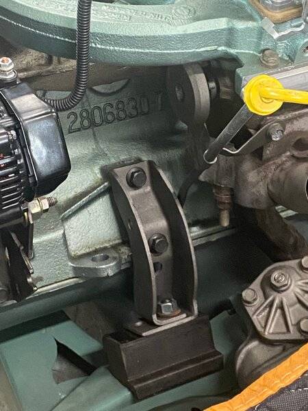

Cutting and drilling 5/16 plate is a pain. The pink/fushia slave is from speedway and had very good reviews. It's 7/8" bore, the other one one is I'd say 3/4" bore. I made the bracket to work with both just in case
one doesn't travel as far as need be. I'm waiting on a couple 11/16 spacers, the 3/4" nuts were just around and really need to be 11/16. I don't know what length hose I need until I re-install the engine/trans later today. I'm anxiously nervous to test my fabrication and choice in hydraulics. If not, back to the drawing board, hopefully not. I hope the pink one works best. The bore of the Bronco(should I say that?) master is 7/8, so I've read.
oh, the ardvark depression where the rod goes through, I could not find that concave washer so I bought a chevrolet rocker arm pivot and fits really good;)

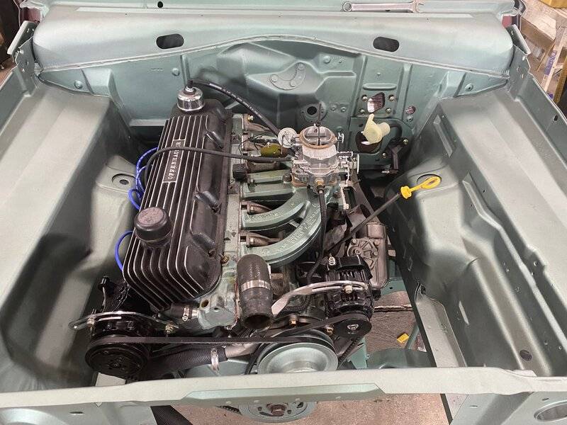

I think I've done enough for today~ I can say I can put a slant 6(mine anyway) in record time. I had to install the exhaust to make sure all is well coming down from the clutch master.
this seemed like the logical direction for the slave inlet
Racetune makes a 90 degree fitting AN-4 which (I will order in a few minutes)
I will be wrapping the exhaust eventually
I'd say it looks pretty beefy;) I'll soon remove it all and paint the parts, Allen screws are coming to mount the 5/16 bracket to the bell housing and of course the correct spacers.
When it comes time, I think I can take the slave and master and bench bleed them, then re-install and just bolt up and push the pedal.
Thank you, George Jets turned me on to the Bronco II clutch master many moons ago, and it was the ticket to the to making this happen~ so many thanks to George;) Now if it will just work:thumbsup:

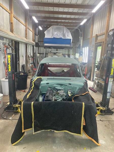

Nothing here other than there's touch up to be done, omg, just a bunch of stuff. I'm kind of shopping for a manual steering gear, Glen pointed to some new ones on Rock auto, but darn it~ meh
Still waiting on the drivers side glass, and where is my headliner!!! grrrr
