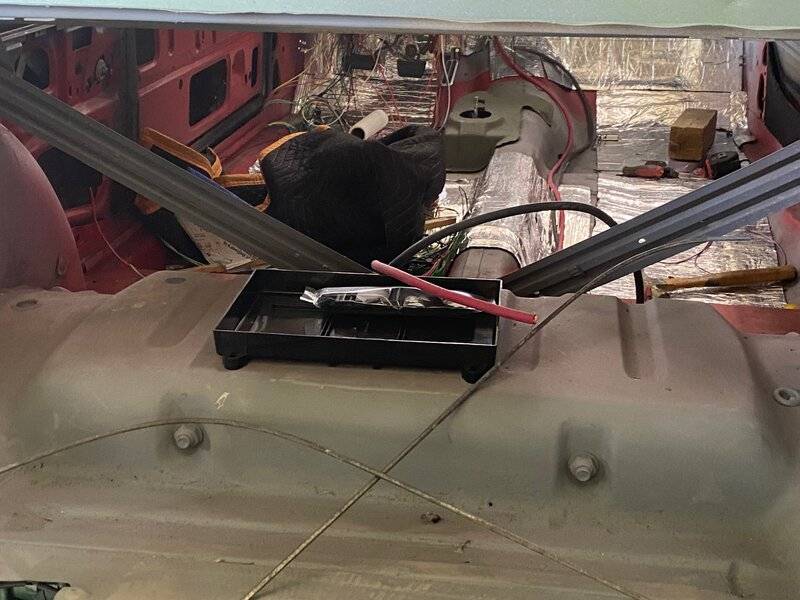

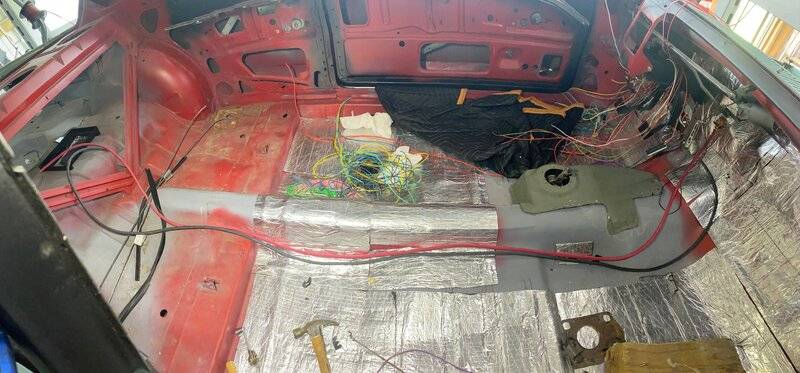

I like how you routed the starter cable. Would you mind showing how you routed the cable on the interior side?
Thank you :thankyou: It's still kind of in the rough stages~ I ordered this kit from Speedway and thought sure 10 would go along the pathway of the drivers door~ so had to choose the only logical path, sure wasn't going under the car.
The ground cable will go through the firewall via a regular grommet and bolted to the block and there can be a short ground from the block to the chassis. Where the two cables hit the back seat metal part, I'll put grommets there and go through the metal part. I'll be laying down some jute? stuff to surround the two cables in their path, then secure with duct tape to prevent wire/cable movement.
carpet should conceal these and with the dash in place should be unnoticed. Just to the left of the firewall connector will be the starter relay. Its not there yet obviously ;)

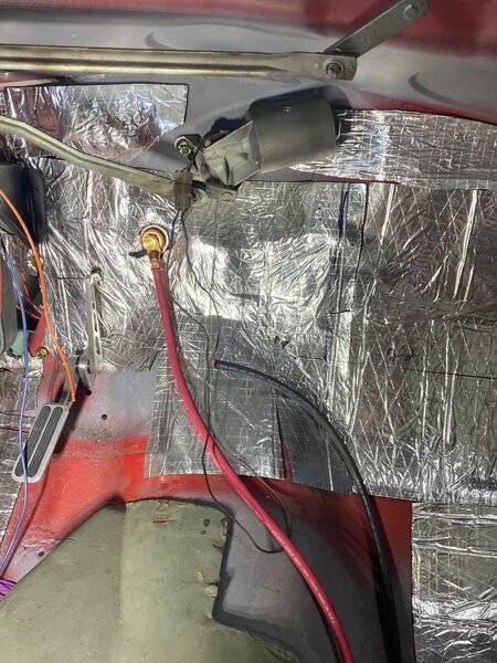

Thanks. I was really in interested is seeing whereabouts on the fire wall the starter cable lands (on the inside). Looks like a logical, yet clean spot. I'm doing the same on my '66 and still need to figure out where to punch through the firewall.
