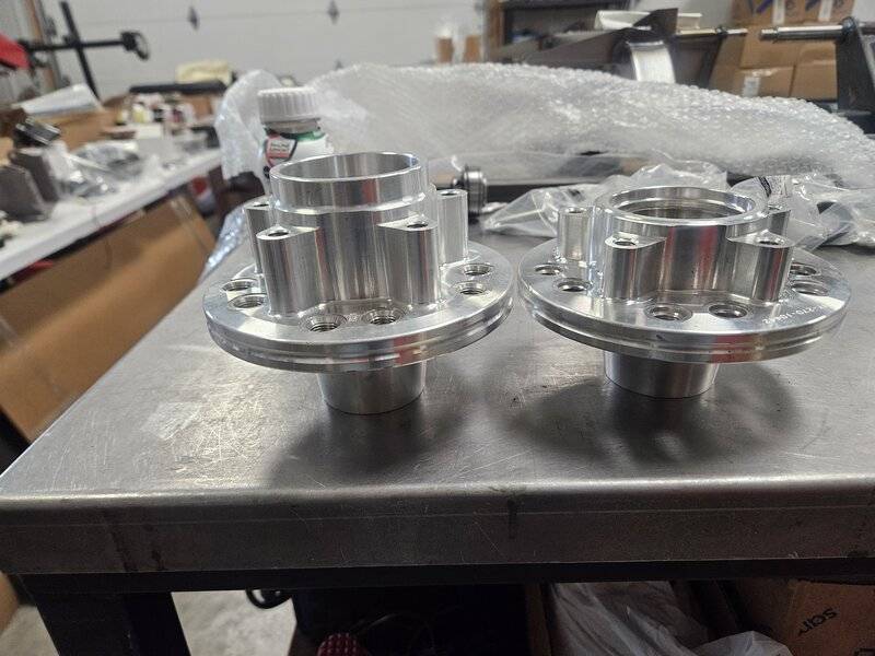

I have both old and new hubs. If I get a chance today I will snap a picture of both and show you what exactly to look for.
Old hub is #FR-278-7279
New hub #HY-270-10442

Wilwood Disc Brakes this is the hub for 11" rotor, other part # (HY-270-10442 is for a 12" rotor
looks like there is .420 difference narrower on the 11252 hub vs the one you have. I am not sure what the length of your control arms are, the HDK arms are not only adjustable, but start out almost an inch shorter than RMS or Qa1.

Do you pick up a total of an inch. 1/2 " on each side with your k frame? The new hub would give me another .420 or approximately 3/8" more to each side than what I got now. Do you think I would pick up the 1" from the k frame I have now to your current k frame?

The .420 per side is a given, but to tell you exactly how much farther the HDK adds, I need more data, but from previous experience, the HDK is and can be adjusted narrower.
