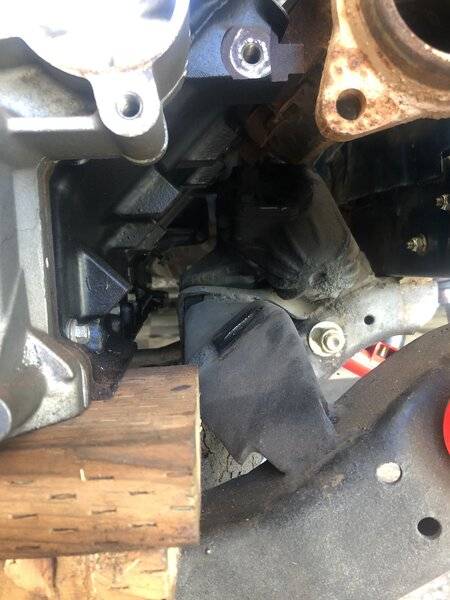

Here is a picture of the Motor I'm getting tonight.
This is the two transmissions first it the 46RE I have, and on the other is the 545RFE I'm getting as well.
These are the alt relocation mount Holley offers. I like the 1st one but depending on the fender wells clearance the 2nd one maybe what I use.

Ha, the motor I'm getting is out of a jeep Commander and has installed already (see the motor picture above) the smaller Alternator assembly. I may not have to worry about it at all.... :rolleyes:
Looks like a sweet package.
Only thing I would add to it is a cam. The 5.7 is kind of a truck motor and I always wished mine pulled a little farther up rather than run out of steam at 5200 rpm. Not that it wouldn't be fun either way, but I would want something more 6.4 like if it was mine (maybe a 6.1 cam?).

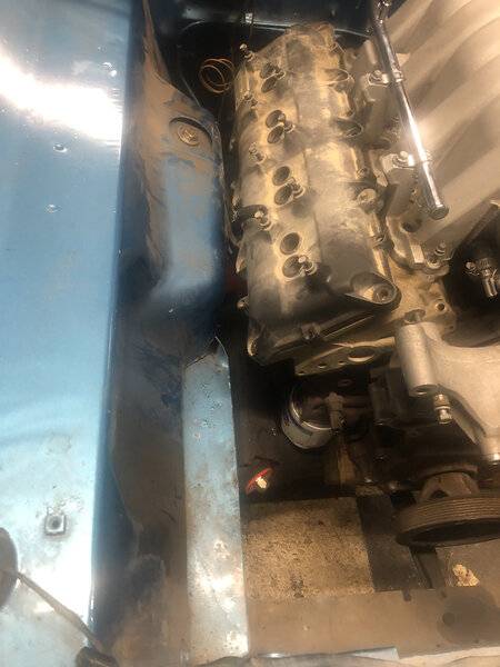

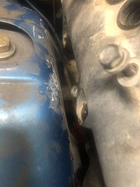

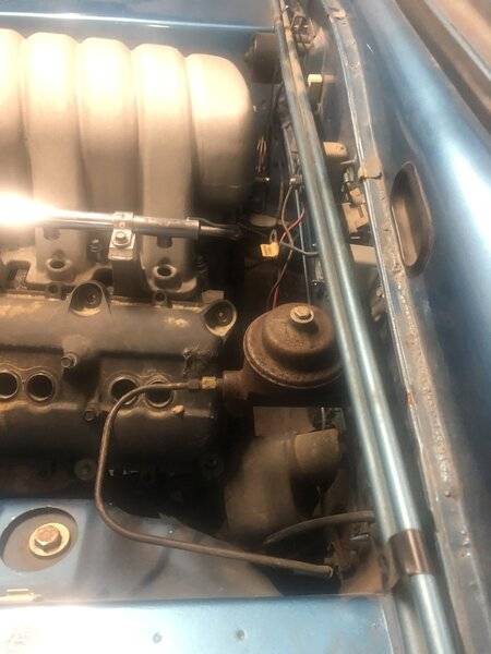

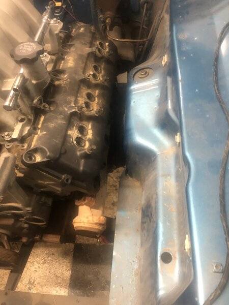

Yes I did a 66 valiant ( early abody ) with stock 6 cyl K member super tight lots of mods to tunnel and cross member. Also I'm using manual box with jeep manifolds. Had to file down the side of the manifold to allow the steering shaft to pass and cut back the outer tube up to the firewall. Added power brakes had to move the booster to the left side about 3 inches.
Pure sexy thanks for sharing.

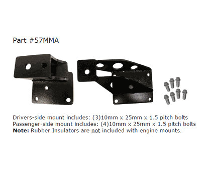

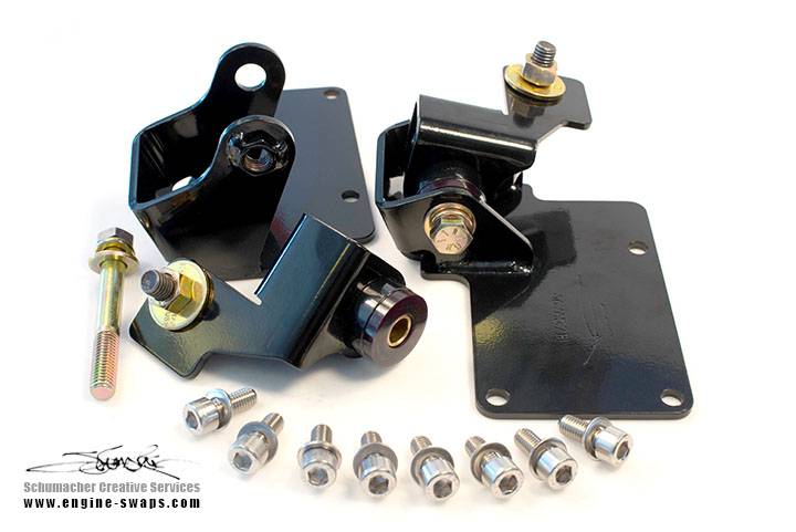

What motor mounts did you run on this.
I've got two I'm looking at
the TTI57MMA
Or the Schumachr kit SCHA67H6
the TTI57MMA
No one made mounts for the early A body with G3 hemi motors. So I made my own. I found a set of flat plates that bolted to the block and started from there and I had a set of schumacher poly loc B body that I had laying in my garage. Then dropped the motor in place with a jack stand and shims right where I want it then started building my mounts. Tacked them all together pulled the motor and welded all togeather. Remember the center of the crankshaft should be offset to to the passenger side about 5/8 inch I used the attached chart from tti.
