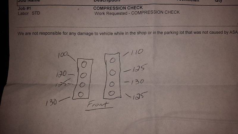

I had a compression test done monday to see where im at as far as cylinder condition.
Heres a pic of the results, not so good.
My tax return won't be enough to do a rebuild this year lol, and I really need to address other issues like the rear leafs and new rear shocks (and one tire) anyways.
So my plan is to check and adjust all the valves to spec (got alot of good info from FABO already) and add engine "Restore" as directed and see if that will buy alittle time before I get it rebuilt while I work out some of the other bugs.
Also can anyone suggest a good carb and cfm number for when I do get my 273 rebuilt? I will be upgrading from the stock 2 barrel to a 4 barrel and using my Edelbrock D4b intake, slightly hotter cam and maybe the commando style pistons (if I can swing it) . Not in a hurry as I will be saving up most of this year. Thanks all
I could see valve adjustment causing some of the variance you see on the comp. test. As far as when you go to 4bbl small blocks like 600cfm or smaller.
Thanks, I was thinking between 500 and 600 so thats good to know.:thankyou:
How long was it sitting before you started driving it?
If you have another vehicle to drive pull the plugs and put some ATF in each cylinder and let it sit for a couple weeks. After you have smoked out your neighbors, recheck compression dry and then wet (two squirts of motor oil per cylinder). The ATF will help free up any stuck rings and wet and dry compression gives you a better idea of true ring compression.
It sat for about 19 years before I got it running. Ive changed the whole ignition system to an electronic one, had the carter 2 barrel carb rebuilt, new gas tank ,lines and fuel pump, belts,plugs, and all fluids.
I havent removed the valve covers yet though. Ive put about 525 miles on it since I got it fired for the first time. I ordered a set of valve cover gaskets so ill be ready to check the clearances soon hopefully.
