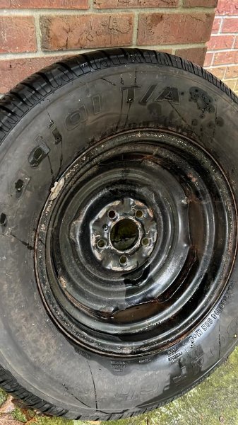

Here are the wheels in question. I have SEEN them on his 68 Dart, but paid little attention since they were not for sale THEN. They are a sorta "semi reverse" wheel.
Looks like a good chance they are pushed right to the edge of the fender lip, if not into it.
