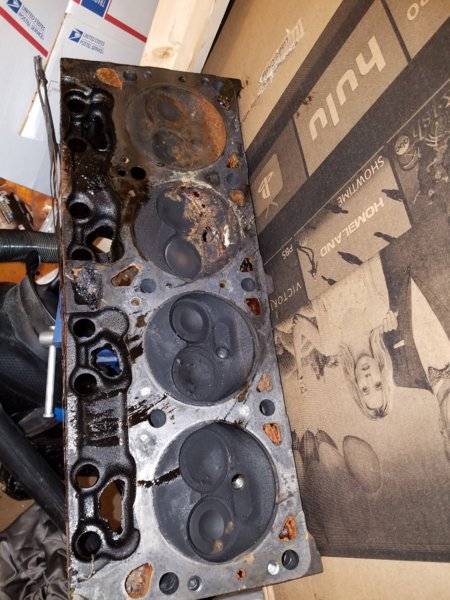

302's are closed chamber
#302's and 178's,234 and 920.
View attachment 1715238426 View attachment 1715238427

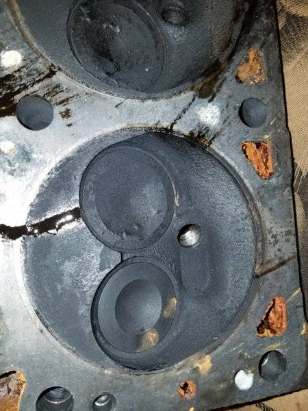

Has anyone here milled 302 heads before?? And know the amount shaved per 1cc? I have read that on open chambers such as 360 heads its approximately. 0048 or .005 for 1 cc it has to more for smaller chambers I just cant find an exact number.
Those look good. Mine are 63 without milling unless I did something wrong lol. And those look smaller than mine.
Maybe down to 57. I can't remember and I don't think I cc'd them after they were milled. With the Egge pistons and a thin gasket it was 9.6/1 static.
Yea I bet so. 9.6 is where I want to be with my 318 I dont think I'm gonna make it on my budget tho. But ideally that is the goal. Maybe someday I will be able to afford to do it right. With .03 shaved did you have to mill the intake and or change pushrods?
Both. took .020 off the intake and got different pushrods. I shimmed the rocker shafts too. It's in my thread if you want to go through it.
I don't know about toolman, but I've shaved small block heads lots of times .040 and never shaved an intake or changed push rods.
I may try it if I can get down to 57 cc that is 1 per .005. So .005x6=.03. With a .028 mr gasket head gaskets will put be at 9.5cr that is pretty darn good for a street combo.
