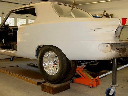

You dont have to move anything putting the wheels all the way up is just part of the Look, The only issue you might face is fenferwell header clearance if you are running them. Both FunnyCarFarmer and myself have early A-body strait axle cars so feel free to contact either of us with any questions. If you arent going to move the wheels foward I suggest the Speedway motors kit it has the shortest spring.

You should be fine. I echo what Bronx mentioned. Speedway kit'd be about the fastest, cheapest way to go. But don't plan on any wheelies, or pothole bouncing. Alot of gasser guys are beginning to see bent kingpins. I'm not sure if its just due to the high spring rates, or the straightaxle tubing being on the thin side. Alot of drag guys are getting them made out of chromoly steel. You could always just grab an A-100 assembly. My guys up your way tell me they are plenty in the wrecking yards up there. Just swap to a shorter spring, cut five and a half inches out, ah,- - - - nevermind. Maybe its just alot more simple to order a Speedway kit.

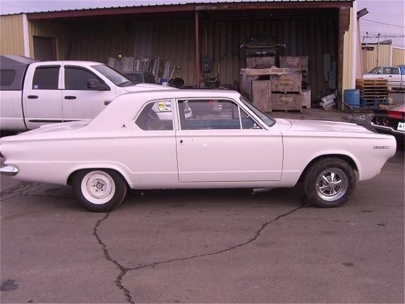

I too am considering the straight axle option. I'd like to chat with the Farmer at Springfling about the motor mount placement and the steering options

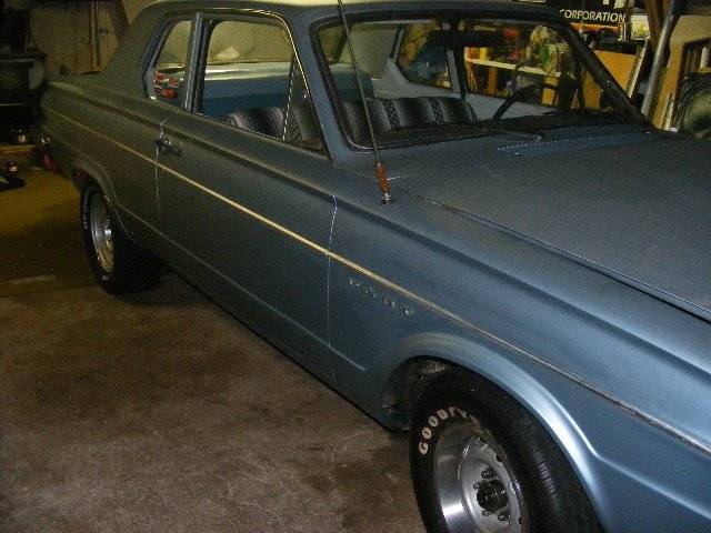

I,m getting a little interested also,don,t see many Gasser looking vehicles up my way.Scrapyards were all cleaned last year when a Dodge minivan would get ya $600 for scrap!All old heavy stuff was scraped.What a shame!Any sites for buying stright axel kits would be appreaciated.

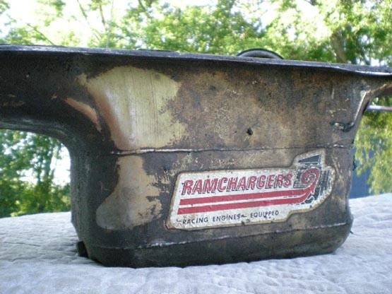

Incidently the original rear from the Pup is sitting in my garage. After the Hemi made so much power, he built a Dana, and I bought the 8 3/4. Here is another little gem I was thinking about using in an AWB...
