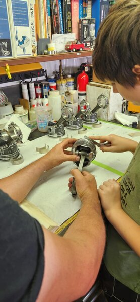

Ok, I took a day off work today to do some engine work on the 318. We got rings on, checked side gap, got the bearings scuffed with gray scotchbrite, and installed. Will install them later today. But I aim to have all 8 in by tonight. Hell they should be, since the hard work is done. I could not find a ring clocking sequence in my factory service manual from 1975, so I went with the one I found off google. It makes the most sense to me as the ring gaps are 180° apart from one another.

Just thinking about that this morning. It must be the aircraft mechanic in me. I am extremely fussy and picky about how something is at work. It has to be 100% right before I stop with it. Dittos for at home. Wife watched me install a pair of these pistons the other day when I assembled this. She said I made it look easy, and that she loves seeing me do work like this.
