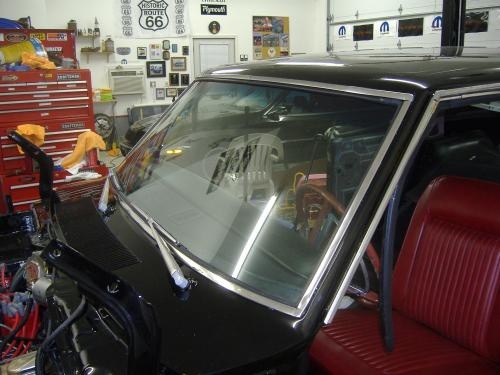

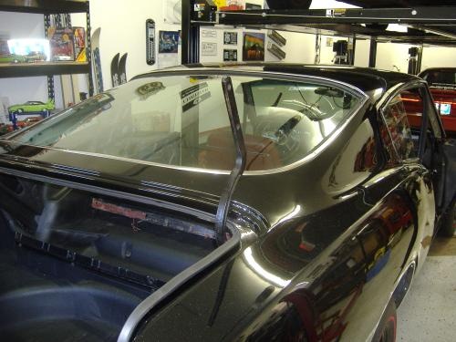

Mine came with the trim.....had never been installed and the clips had not been installed.
Some one had already found the trim and threw it in the back of the car.
