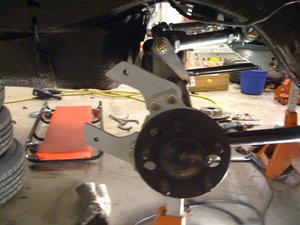

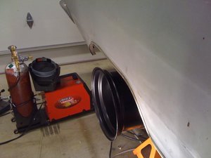

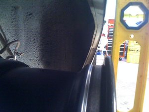

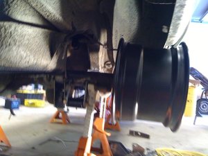

Got the steelies today. Mocked up the new Rotors and set the Wheels. I was wrong twice on the narrowing. I am not kidding I measure everything 10 times! Good thing I did............Needs to be shortened 3 1/2 inches on each side to sit dead center in the wheel well.......Just so you guys know this was a B Body Housing. I didn't have time to see if the Tail Pipes would fit, hopefully tomorrow.

Anybody got a sawzall haaaa

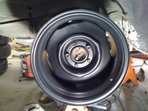

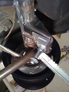

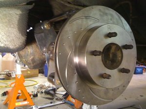

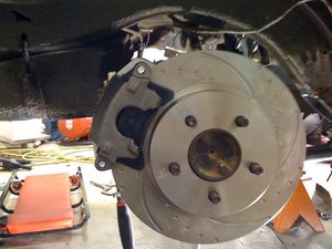

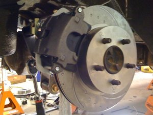

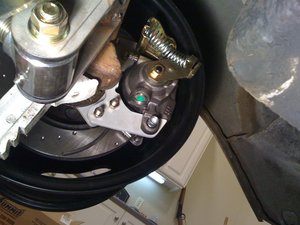

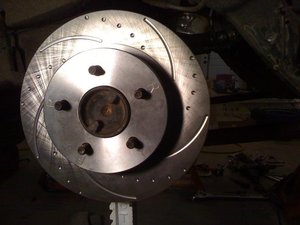

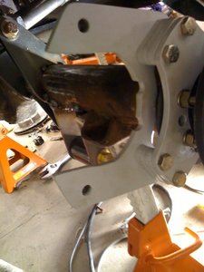

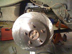

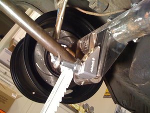

Mocked up one side of the brakes today to make sure the calipers would clear the steelies......DANG it is close but it clears. These Rotors are 11.25" I was going to go bigger but the look I am after the BIG brake kits will not fit. This is as big as you can go.
I also raised the suspension up to see how LOW it would go. It will go easily another 6 inches lower than what you see in the picture.

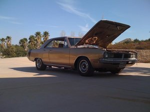

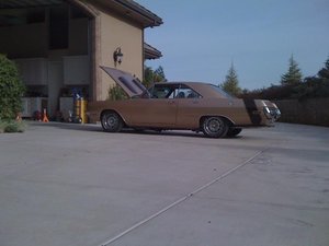

As far as the pinion angle goes it is at 0* and I can move it to wherever it is needed. I will set it and forget it after the drive train is installed. On my 70 Dart the tail shaft of the trans was pointed down about 2.7* and the car has a 2* Rake front to rear. I had to put a 6* shim in that one to bring it to 0 with caltracs it moves about 3* up under load to make it just about correct with that set up. What I like about this set up is I just loosen the jamb nuts on the link bars and twist the rods, it is actually very easy to adjust Pinion and tracking, alot easier than I thought and I like the fact that you dont have to Take any of the bars off to do it.
I want it to set lower than my 70 does here in this picture by about 1-2" or so.
This picture is before I changed the tires and has 14" wheels.
This one shows with the new tires on still with 14" wheels

I like it! If thats the same stance you intend to use it's great!

My buddy's 70 Dart sits probably 2" higher than my 70 all the way around. I bought that car with 1" lower springs on it. I didn't notice it til my buddy brought his car to my house, he looked at the springs and found the de arch on them by the rear shackles.
Thanks everyone for the pump up. I will hopefully get the rear end out this week end and finish weld it all up to take the housing to be shortened. Oh and I forgot to put int the spacer where the Backing plate will go so my final cut on each side of the B Body housing will be 3.75".............
Hey MadDart the stance on your 70 Dart is similar to my 66 Dart.I have the MT 275/50/15R on the rear of the 66 Dart(26 inch)I,ve had them since last season,so might aswell use them up then will go to the taller 28 inch ones.You,ve done some nice work on your 4 link setup,looks beefy.I also really like the color of your 70 Dart,you don,t see any that color.Keep up the great work,I,m waiting to see how the stroked 402 works out for you.:cheers:
