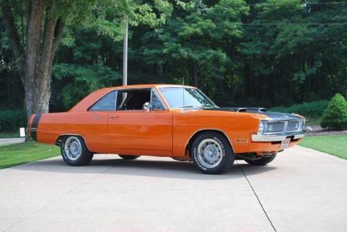

My dad runs 15" x 7" (with 4.25" back spacing) Rallye wheels all the way around on his 70' Swinger and has no fitment problems.

I have 17x7 with a 4.75" back spacing with a 215/50/17 front, and 17x8 with 5.25 Back Spacing with 245/45/17 rear. They are custom offset wheels. I have LBP front and rear via newer disc's in the front and a stock A-body 8-3/4 with 11" drums. Nothing is relocated in the rear, all stock location. I may need to trim and roll a bit in the rear 1/4 only because one side has a replacement skin. The fit is great but you'll need to pony up $1500 to get custom offset wheels.
You can see in the pic below how they sit on the body.
Another post to read: http://www.forabodiesonly.com/mopar/showthread.php?t=225071
