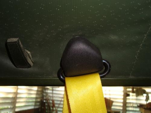

This is my 69 Swinger WITH shoulder belts and mounting.
You can see the large threaded hole the shoulder harness bolts into just in Front of the coat hook.
My 67 2 door post did not have them. My 73 has the optional shoulder belt that you can use. I can't stand how high the shoulder belts mount, goes across your neck area, and I'm tall.
I run the 67 at the track and wanted something in addition to a lap belt so I added my own mount in the post. It's not factory pretty but it will keep my face from hitting the steering wheel.
I'm using the stock mounting holes for a dodge ram retractable set of seat belts I think I'm going to only have to make 1 mounting hole and a bracket for the release on the floor but that should be it, easy-peasy-lemon-squeezey ha
