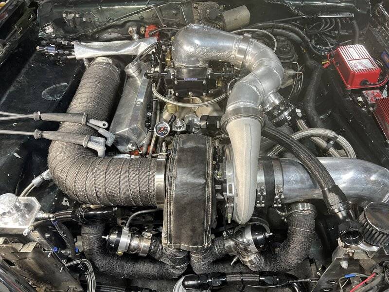

Spoke with the machine shop today, valve covers will be done Monday, I'll get them Wednesday since I need to go out of town for work for two days. But I'll get the pump and bracket mounted and breather tank mounted this weekend, all ready for the last few things then, order the extra fittings and hose and measure for the correct belt needed.

Well got the mandrel mounted, had to remove the washer from my crank bolt for it to clear, got the spacing done, had enough line from when I bought everyhing to plumb the breather tank, and passenger side with the extra fittings I ordered, driverside done as well. Ordered the 25" v belt, will be here this next week, not like I can drive the car since it snowed today.
Are you still getting oil leaks from the main seal(s)? Is it possible the rings didn’t seat on those two cylinders that weren’t firing?
Couldnt tell after the last drive if it was from the rear main, or from the over spray in the bell housing, just playing it cautious and installed the pump to make sure if doesn't happen. That's what I'm thinking is the 4 cylinders that weren't firing properly during initial fire up and drive and dyno didn't seat so, now there's no reason for them not to seat properly.

Yeah, as soon as I can afford to go back, had some expensive house repairs come up and set that back a bit. But will get it running again and drive it around more hopefully with the vacuum will seat those cylinders better.
Started the car today, had the hoses to the valve covers off just to make sure I didn't swap the lines. But had suction from both lines. Hooked them back up, couldn't go out for a drive it was 15* out and still a little slippery with the ice still out. Hopefully this next weekend will be a tad warmer to take it for a drive.

Well weather was good today finally and no f-ing wind, took the car out to the gas station and around the block just cruised, pulled back in the garage and no more leaks. Now to purchase the auto tune from diy and get this thing better tuned in. At least this time my water pump belt stayed on and didnt shread off like last time.
Will do and good to know, can't wait to use it , found some small issues, my oil psi and temp both quite working lol temp the sensor inside broke somehow, can turn the connector and it and inside turns about a 1/4" both ways, psi sensor the connector that comes with the gauge kit was loose, so swapped that out, checked all grounds and actually moved those two grounds from battery to chassis.
The motor that was in the car and I took out when I sold it to you had the same problem. The rings didn’t seal correctly on the Dyno. I tried a lot of things like you did and none of it worked. I didn’t have to change any of my gaskets though put a GZ vacuum pump on it. Problem fixed.
Same motor that is now single blow through CSU e85 custom built Carb. Four bowls and four Needle & seats. The vacuum pump is under the driver side blow off valve.
That's one sick motor. Yeah all the gaskets like yours were good too, just changed the rear main just in case since it was coming more from there. Even had it diamond honed at QMP. Just one of those things that happen. Can't wait to hear what your motor runs.
