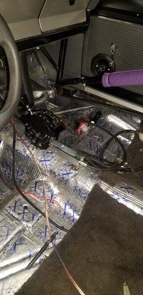

Well now I'm not sure wtf, got the new shifter in and the same damn thing, park or third but now the sidewinder in between gears my valve body is shifting tried both their swing arm set up, went straight to the transmission lever using theirs, same damn thing shifting between, and used the b&m lever and again same thing. Starting to think Im cursed to not be able to get this thing all the way done lol looking any other pictures had the angle off on their bell crank, need to go through the floor board. So I'll try that better, hopefully this works lol.

I know, and that 20% kicks my butt. Yeah that pic I posted its such a odd angle to come in for the cable especially with the 3.5" pipe sitting close to it. Will try to take a look and see tonight and get the bell crank put all back on and go from there, it must just take all that to work no other way around it.

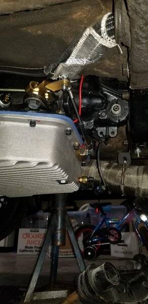

For this one its the routing and they said I should be able to go straight to the trans lever but don't think it can on the 727 it needs their bell crank and routing the cable how they say, so I'll drill another hole and route it through the floor board as they say, lots of people havent had any problems doing it the designed way. Will see how the passenger seat fits after this lol
Well the curse is lifted lol jk well no shorter way around these sidewinder shifters, have to do it as they say. Got it all connected up, just need to throw a better cotter pin in the rotation shaft and it has and goes into all gears. Will secure the cable, put the carpet back in, bolt down the shifter and see how the passenger seat fits now. To test drive soon and check all gears when driving. Glad I have all of you guys for support.
