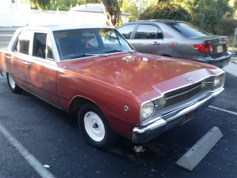

Anyway, I picked the car up off Craigslist, and I think I got a decent deal. Body and motor had 83,000ish miles on them and the paint on the exterior was all redone. It looks nice, but the paint job is definitly a 10/10. You've heard of a 20/20 paint job? Ok same thing, except you can get closer and it still looks nice.
Orinally I thought the copper was painted in the interior and engine bay and trunk, since the interior panels were green-I thought the car used to be green. Lo-and-behold. I decoded the fender tag and the car was actually the color it is now, but not two-toned. The white was added later. The interior was ordered in green and also there was a green stripe across the back. Blech. I forgive the original owner and will chock it up to having too much money while high in 1967.
The interior is what I'm really ditching the most of in this project. I'm not looking to restore it fully, more than I want to have fun with it, while driving it. So, let's fastlane to where I'm at now:
This is how I bought her, and after a good washing.

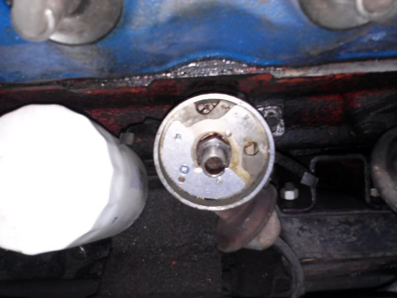

After that I installed an electronic ignition kit and removed the points (I kept them). It got rid of a misfire at idle that caused shaking.
I also cleaned a lot of oil out of the distributor while i was doing it

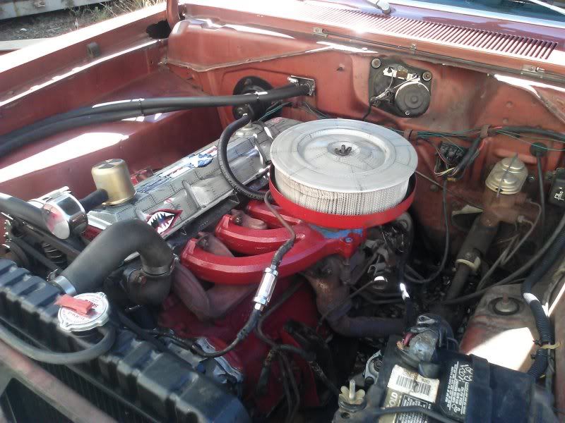

A lot of stuff seems to leak... which I guess is expected. As you can see the block is red and the head is blue. I'm assuming the head got changed at some point. The valve cover was still red though - and it leaked real bad for some reason. I opened it up and changed the gasket. It did not fix the problem. When I retightened it a second time I noticed it didn't line up to the bolt holes very well. A few dents in it and cracks confirmed it wasn't the right shape anymore - possibly banged around somehow. I found a cheap chrome one, replaced with the same gasket and I have not had it leak yet - though I know it will eventually. At least it didn't happen immediately.
Also in those photos you may be able to tell I repainted the air cleaner. It still has the stock decal though - which I'll change out later. The radiator was replaced by the previous owner and he replaced the 4 bladed fan with a much larger 5 blade fan.

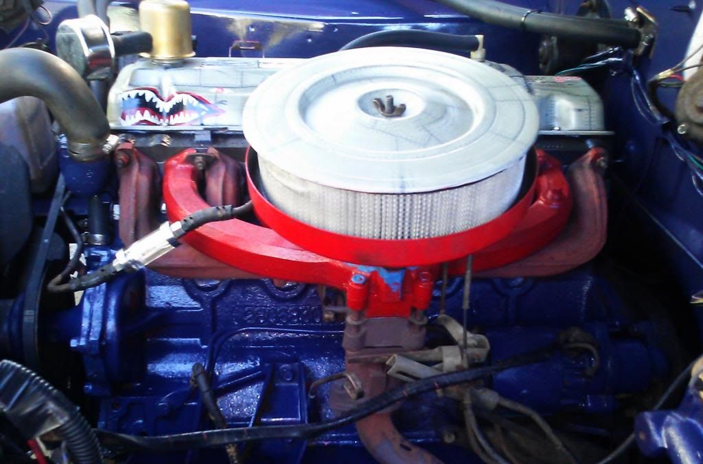

I put the engine all back together and had a WWII setup in paint going on for a while in the dirty engine bay. Chased down a heating issue, and then replaced the radiator. Voeltagear on the site has been very helpful in giving me step-to-step heat chasing information, and when the fan he sent me pops up, I hope the issue finally goes away. We'll see...
After a while I went a different color route with the motor. All the reds and oranges and gray made it feel too much like a desolate wasteland. It needed color. I took the valve cover off with the nose art, and it is sitting. I think I may give it away on here. Don't know yet.
So I went with a dark blue, almost purple oil by 1Shot. I made it by eye till I was happy, but I mainly used a process blue, and dark red. That was to be the undercoat and also the detailing to help seperate the later colors. I used a lot of sandpaper, and a quick primejob beforehand, and got everything I wanted to be covered later.
With the thinner and all, it still took about 4 hours to paint - entirely with a 1" purdy angle, and a sable.
Then I found a really cool Hammered aluminum finish paint by Rustoleum. I wanted to do a chrome, but opted for this, just for some texture. I definitly like how it turned out. Then I hit some accents (without texture) of L Purple (1SHot) The hammer finish stuff insists you don't thin it, and once you brush it on, it makes sense. The paint coheres and pools together and then forms the "wrinkles" that make the finish. Really cool to watch, but you have to move around. So basically paint one spot, then move to opposite end of engine bay, and keep going like that, because if you brush over the stuff you put down, it lays it out, and you don't want that. It ruins the reaction.
