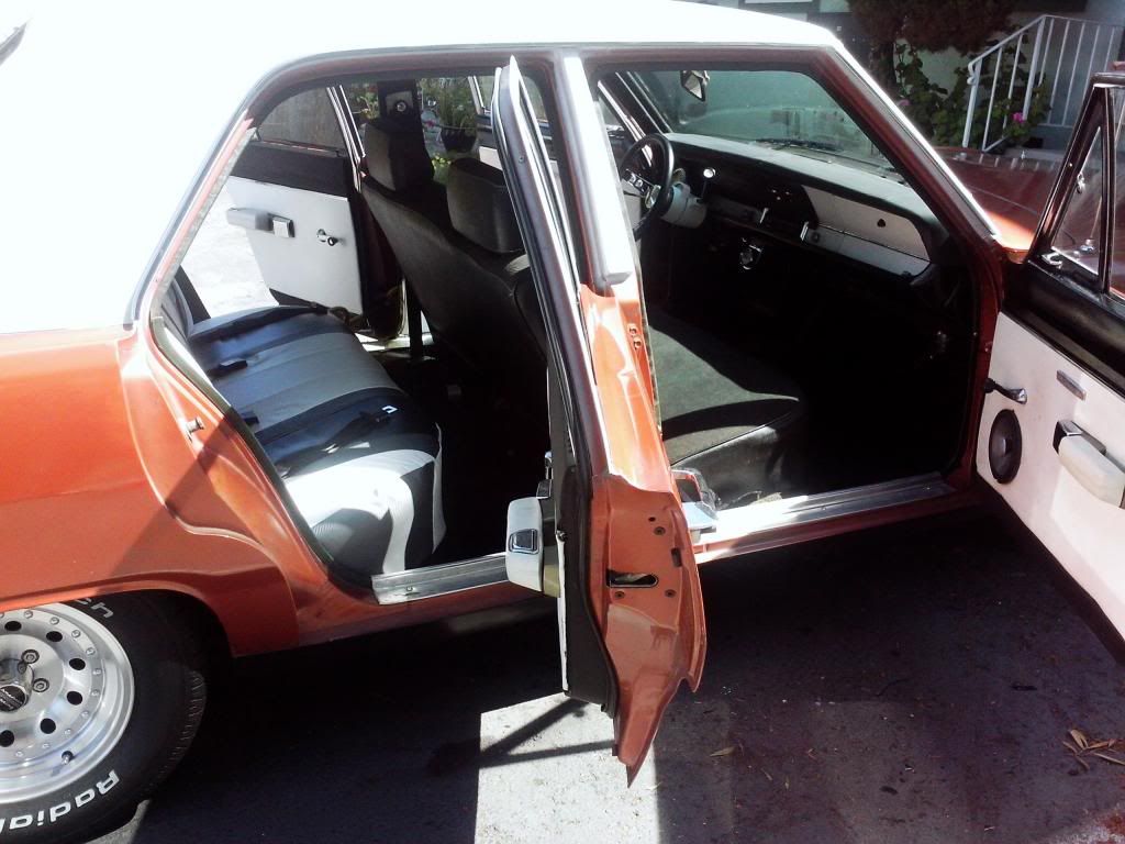

I was only faced with one layer of sheet metal at all holes. These in the rear under the hinge were quick.
Maybe take a picture of the area you're talking about and I'll give you a better option. I spent about 2 hours alone just looking for ideal places to drill, opening and closing all the doors, and double checking nothing would get pinched or tugged on.
Nope, I just "borrowed" your locations. Got all of that done, just took patience and a doublecheck of the holes I was drilling.

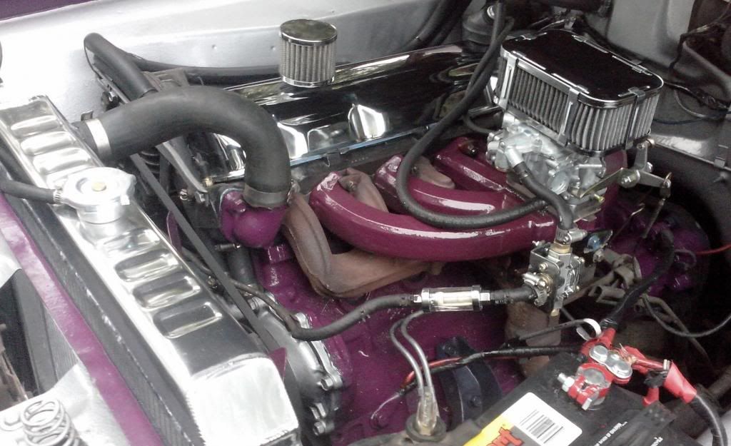

I brightened up the engine bay again, and eliminated some of the purple presence, which looks a little better.

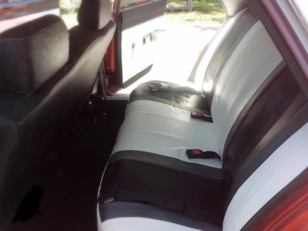

The car also got a much needed interior cleaning...

Can I ask you some questions about the one Shot? I've never heard of it, looked it up and it's pinstripe paint, correct? Did you just brush that on the whole engine bay? I'd love to paint under my hood and also the firewall/skirts but I don't want to spray it. Did you say you mixed some up too?
Really nice ride!
1shot is a really nice oil based (expensive) paint. Its intention is for sign-painting or pinstriping initially, but I like using it on anything. It is mixable, thinnable, etc, and will take a tint of other oil based paints, but I don't recommend using anything other than it to mix with. For the main part of the engine bay I used "rustoleum hammered aluminum" finish. You can be a bad brush-artist and it will still lay down evenly everywhere. One quart was $16.00.
The rest I degreased all the parts, and whatever could be taken off easily got painted out of the car. The color I used was "L Purple" which is number 162 in their spectrum. This and other colors like this tend to be on the more expensive run, but i easily painted the entire motor with less than a half quart. Once it's thinned correctly it lasts a while and has some really nice self-leveling qualities to it. I took it to a show and everyone really enjoyed the "purple motor".

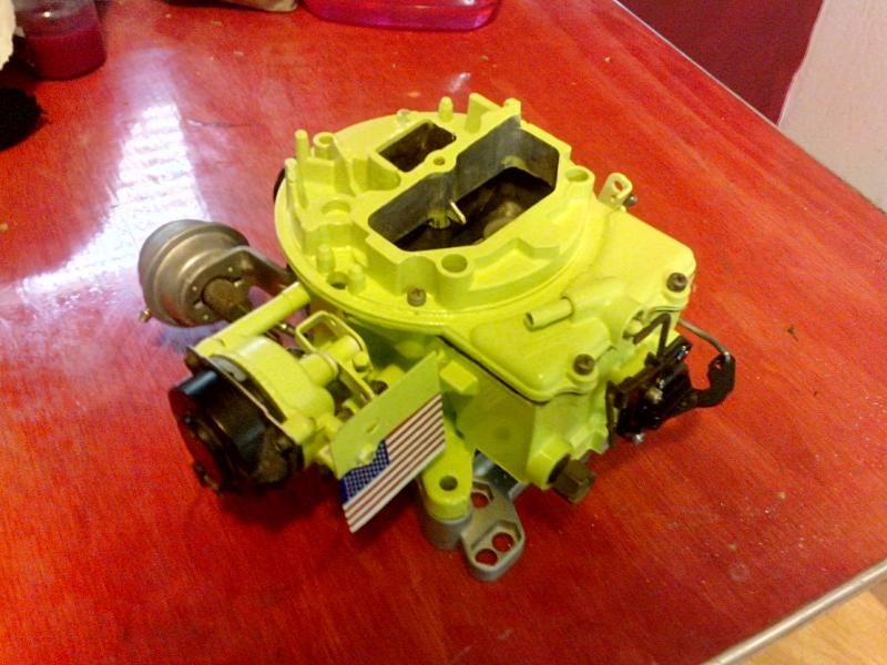

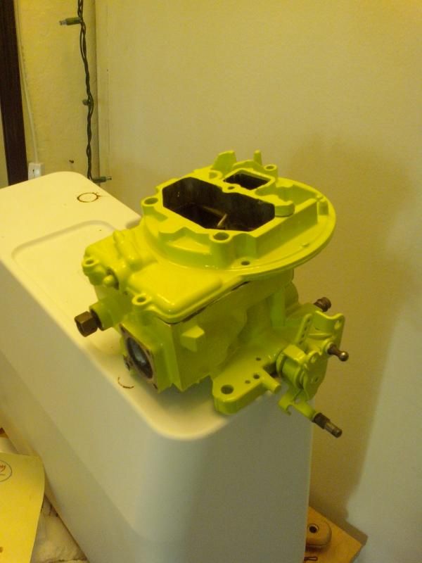

Speaking of which, my Motorcraft came, and I already tore it down, removed the choke, and cut most of the choke riser off.
http://s43.photobucket.com/user/ser...oost/IMG_20140707_175112_zps7a482674.jpg.html
http://s43.photobucket.com/user/ser...oost/IMG_20140707_182641_zpscebf8855.jpg.html

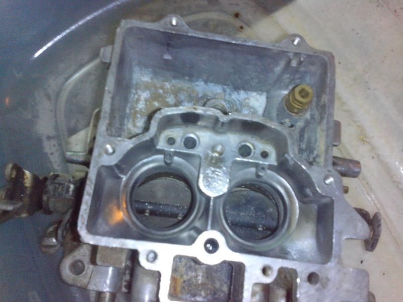

IT was pretty nasty as you can see. It's all cleaned and I glassbeaded the outside of the two body pieces and baked on some cool lime-light green enamel. I did not bead the interior for fear of messing it up. That I am sticking to cleaning.
I also got the rebuild kit and a nitrophyl float. I'm just looking at how exactly one makes the power side larger, and then I'll be able to put in smaller jets. There's a lot of info on Holleys, but the only stuff available on the motorcraft comes from the Ford forums, or Turbo Pinto forums. This carb, however came off of a Mopar 360 if I'm not mistaken, and the bore of 1.21 is actually smaller than my Weber which is a 38/38.

Removed the electric choke, the choke plates, and sawed off most of the choke riser.
http://s43.photobucket.com/user/ser...oost/IMG_20140708_153442_zps2f1fba94.jpg.html
http://s43.photobucket.com/user/ser...oost/IMG_20140708_153446_zpsad6e1505.jpg.html
And both parts cooling off. I know it's 80's but I like color under the hood. It looks interesting.

Somewhere else I read of someone cutting the choke riser off, then layering epoxy everywhere on top to make it smooth - I just simplified it with a nice clean, high-gloss layer of paint for the air. The paint itself is so thick that the word "Motorcraft" can't be read.
Well, that's one part down mostly. I just have to find some machine screws that were missing; guess that is what happens when you get a used carb. The vacuum advance pod was off and missing both screws, and the accelerator pump housing was missing 2 more. I'll probably find some at the hardware store.
