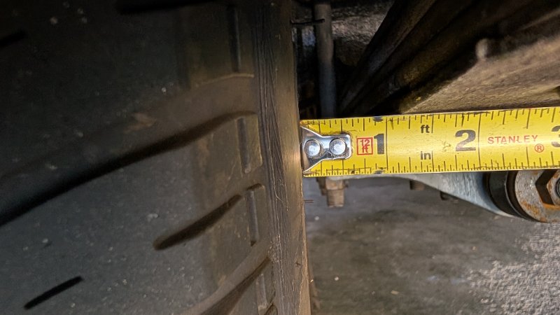

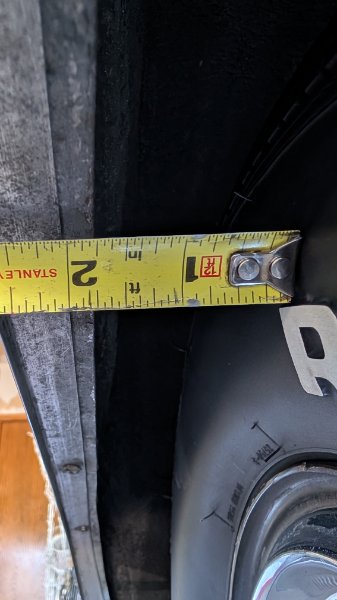

Im upgrading to CPP disk brakes up front and am running a 1.25” sbp to bbp adapters out back. I have 15x7 american racing rims with 4.5” backspace. Can i fit 225 70 r15 without rubbing? The rears look kinda close when i measure with a tape but its all eyeballing and the front i havent assembled so cant measure. If like to order a set of tires today. Any help would be greatly appreciated! Yes i searched and it was not clear at all btw

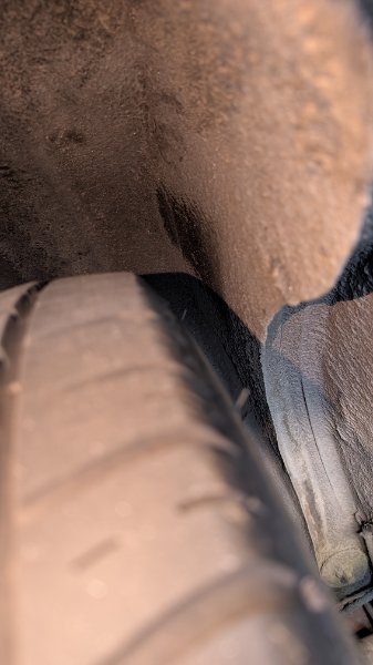

Dark mark is where the tire rubbed under some situation
That spacer is taking up the tire clearance.
Measure straight up from the wheel to the quarter, how close is it?
