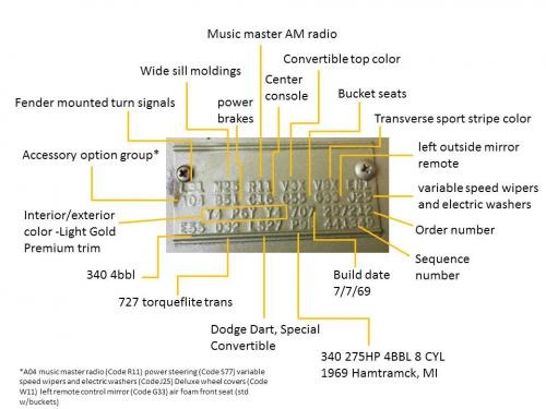

Do you know the color of your car ?
Look for the code on the fender tag, inside the engine bay. Y4 ?
Yes sir, factory Y4.
attachment.php
I was wondering if you ever saw that decode image I did for you. :)

Just thanks you again DDaddy. I appreciate all the help with the fender tag and the photo shop rim options.
