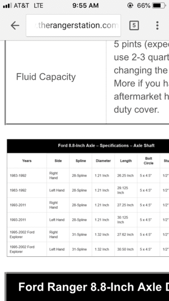

Thanks great thread! Only, this one is out of an explorer and requires cutting the axle down. I hear that the ranger doesn't require cutting.. Can anyone confirm?

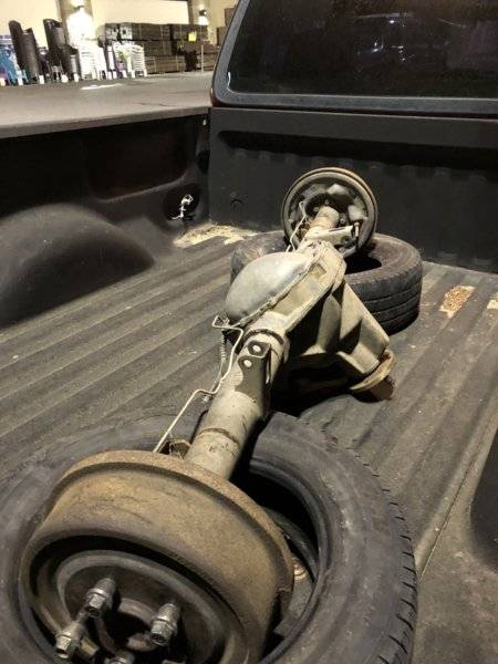

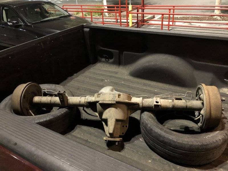

I just got one out of a 91 ranger. 3:55 track lock .my 67 dart 7 1/4 is 57 1/8" flange to flange. Ranger rear is 57" and pumpkin is offset to passenger side by only 2". Still need to weld on new spring perches.
Factory diff is offset also. No cutting required. That's why people hunt for Ranger rears.

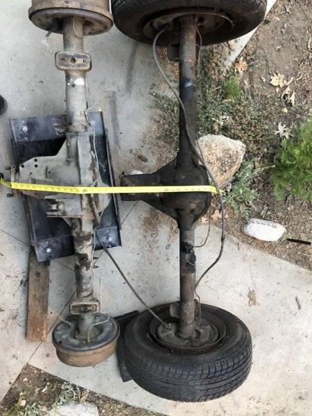

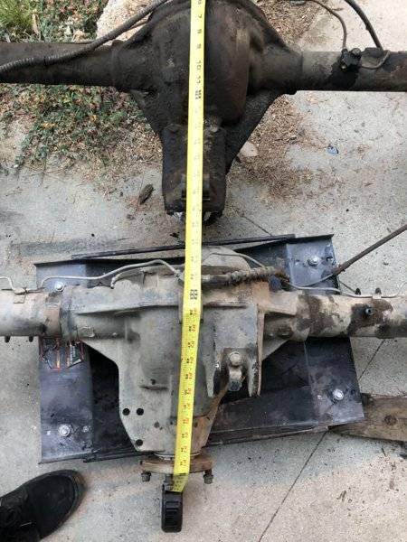

UPDATE: here’s the two rear ends side by side. From what it measure it’s off by about 1” towards the passenger side. Hoping I can offset the motor and trans a bit to compensate. If anyone else has any ideas or insight please share. Thanks.
