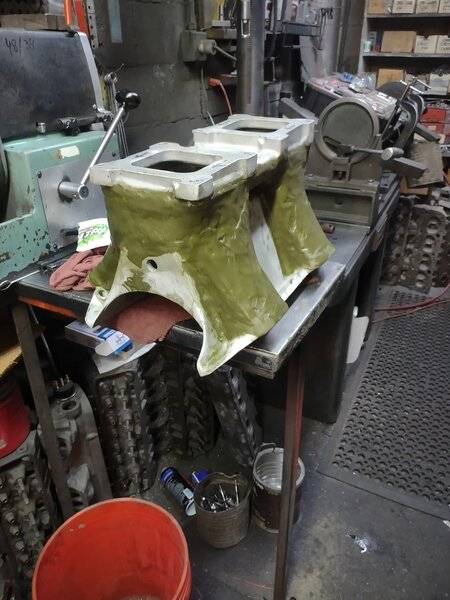

I also put on the final layer of splash zone epoxy, need to do some port matching and see about roughing up the epoxy, splash zone seems to be soft, then finish it with polyester filler and make it pretty.

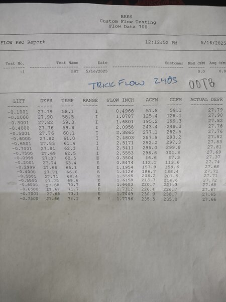

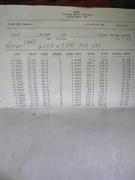

Finally, I have some before and after flow bench tests of ootb trickflow 240s and my ported 240s.
This bench has audie tech software and reads 12% lower numbers then super flow benches compared. The trickflows numbers are really close if the 12% is added. Who knows if the numbers are inflated or this bench reads low ???

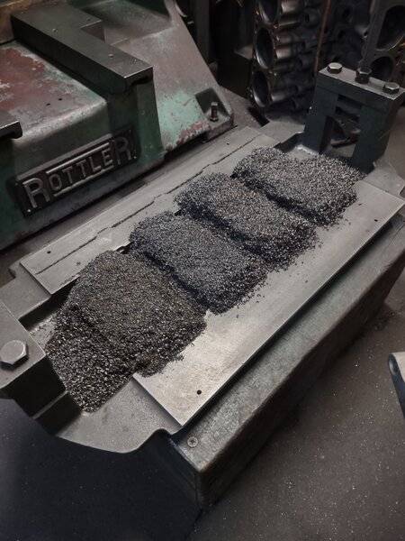

last picture is from boring a indy Maxx hemi block to 4.500, gathered up 19 pounds of hard sleeves.
This bench has audie tech software and reads 12% lower numbers then super flow benches compared. The trickflows numbers are really close if the 12% is added. Who knows if the numbers are inflated or this bench reads low ???View attachment 1716420724View attachment 1716420725View attachment 1716420726View attachment 1716420727last picture is from boring a indy Maxx hemi block to 4.500, gathered up 19 pounds of hard sleeves.
Impressive gains in the lower part of the lift range!!! And also pretty dang good up top on the intake flow. Nice work! Regardless of percent difference for the benches, you’re still able to see the magnitude of the modifications, and that they took you in the right direction!
Hard to believe TF240’s have been out for nearly 10 years already.
The first one I tested here was in 10/15.
They have certainly made a big impact on that market.
