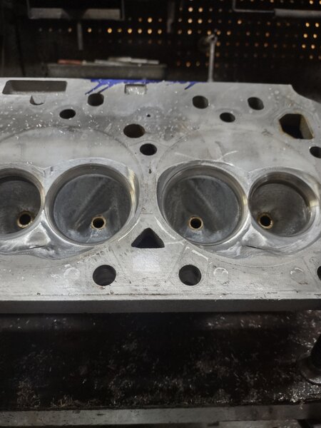

Yesterday I did some extra epoxy work inside the plenum, just gotta sand it down, today also I resurfaced an additional .015 to get my flange sitting flat on the heads.
I ported my heads today. The new port is what I said previously, 2.500 height, 1.300 widths.
I think they turned out pretty nice for just rough sizing, raised the roof .100 ish and blended into bowls, reshaped the wings to face center of the bores.
Sand paper cartridges 40 grit and some burr finish on the floors and bowls coming tomorrow.
I 40 grit cartridge the ****, I burr finished the floors / pinch and right under the seat.
I think I'm done, going to try and get them on a flow bench, will measure the cc's tomorrow

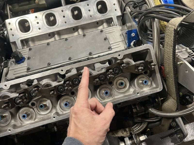

Brought my stuff home to mock everything up.
Ports line up very nicely from what I can see and I have no gaps between the runners and the gasket/ intake face of the head.
This should be pretty good, I just need to finish up the intake and I should have it welded up by Monday evening.

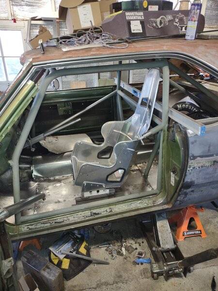

Also since I had to sign for the package I started trying to get my seat more permanently mounted but it's a pita because I didn't do a great job leveling the floor but I'll get it figured out.
Zoom in you can see I have some work to do.
