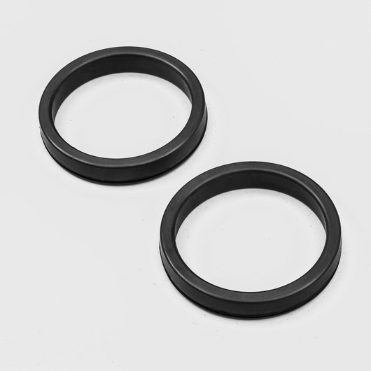

I have searched this forum and can't seem to find the information I am trying to find. My project is a 71 Dart that I am adding the 70 model twin scoops to the hood. I have a factory hood from a 70 Dart that already has the holes/cutouts in place. Earlier searching that I have done lead me to believe that the "inserts" that went into the large holes were shaped like an inverted tophat that was then attached with 4 sheet metal screws in each scoop. This is borne out by the fact that there are four small holes in the hood where the inserts were previously located. However, all I can find in catalogs now are what amounts to a big grommet that is referred to as sealing the hood to the snorkel air cleaner. What I have is a large, circular air filter housing with dual oblong openings under where the scoops would dump. My understanding is that the filter housing I have is correct for the 70 model year configuration. What is the correct part for the opening in the hood? Can anyone with a factory 70 hood please provide pix of the inserts and the corresponding air cleaner housing? Thanks in advance!

This is how the hood should look, and these are the correct inserts, which are available from several vendors.

Thanks OldManMopar, this is what I was looking for. After spending days doing the bodywork on the hood, I left the holes there, thinking that they were needed for the water diverters. The spacing (4 of them around each hole) is damn near perfect. I doubt that the type shown in your pix won't cover the holes. Dammit!

Sorry I dont have a more closeup shot of the diverters, but they are the same, and make sure the thicker part is "up" into the scoop. Zoom in and you will see.

in my experience, get your repop grommets from DMT - many of the others are too small, flop around, I even lost one once!
And the tall side goes up to keep water from sheeting into the hole.
