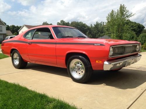

'70 Duster build-up...
Draglites on with (temp) old school L60 rear "Super Stock" bias plys!

Hey Todlich thanks, it's nothing to crazy just trying to make a quick car that's reliable, use as many parts & services offered by FABO members as possible and fairly good looking with little to no money and time...lol
