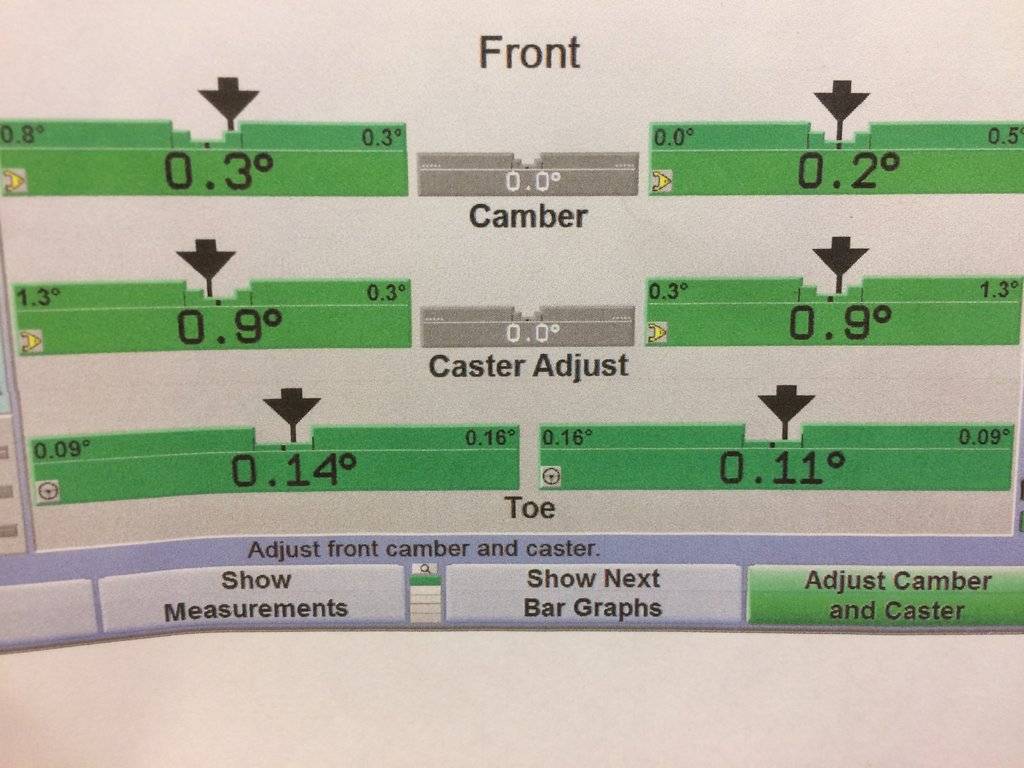

Well I have to say the alignment went well according to the cars drive ability. The sheet I was given after it was completed does not seem to show much similarity to the Skosh Chart above. Do I need to go back or just take it for what its worth since it does drive fine. Car is a cruise night weekend driver.
