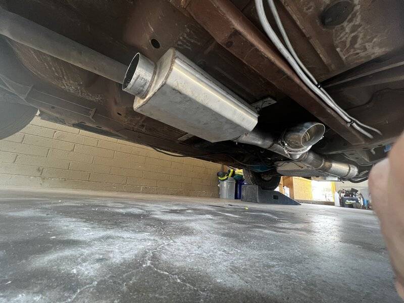

In that video my exhaust was still 4” into a hooker max flow then side exit. Right now I am welding together the rear exit dual 2.5 setup with scat pack resonators. Very little concern for flow as I have also installed a 4” cutout; I just want it quieter for cruising.
Well I’m about finished building the full exhaust. I need to weld up hangers, but the thing sure is quiet with the cutout closed! Should be great.

I'd go with the Holley one, I swapped mine out, its the older style of diy plus the holley can be ran on 0-24volts so you don't need to reduce the voltage going to it. I had the same problem with my old sensor, had to move it to close for comfort to the wheel for it to work best, now the holley is out 1mm and strong signal. Your video made me think about going to some hooker max flow mufflers to quite mine down just a tad so I don't have to yell when I'm crusing my car.
If it happens twice more (since I have an extra) I’ll take your advice and switch to the Holley. The hookers sound pretty great and flow even better
