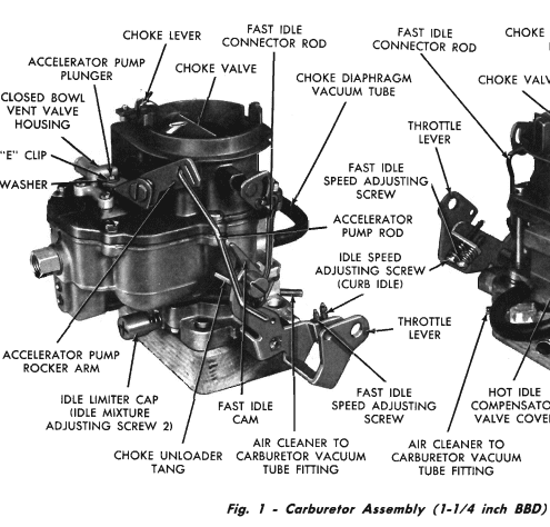

2 thing not addressed is the choke pull off and the choke un-loader.
Choke pull off is vacuum operated and if set right will open the choke slightly after the engine starts and vacuum increases.
Choke un-loader is manually operated and opens the choke when the accelerator pedal is pushed completely to the floor in a flooded condition
Both need to be adjusted correctly.

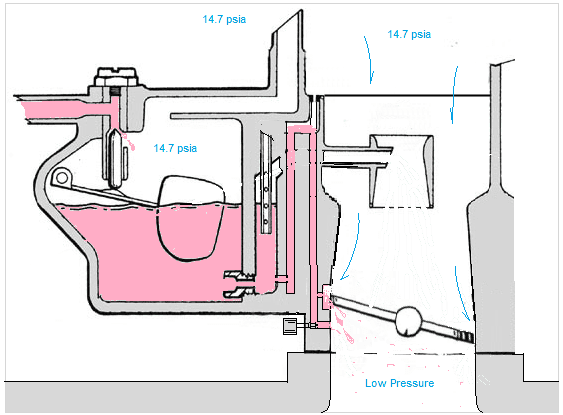

So when people always say if you think it’s flooded push the pedal to the floor and hold it ,what’s happening in the carb both with fuel and air?
What happens is both the throttle and the choke are held open. This results in air but no additional fuel flowing into the intake.
At idle and off-idle fuel flows from the bowl to the intake because of the difference in pressure.
Another way to think about it is the pistons moving down create a vacuum under the throttle plate.
When the choke plate (not shown) is nearly closed, that increases the pressure difference and reduced the air mass density.
The action of opening the throttle does actuate the mechanical pump shot. So that's why pumping the throttle is sometimes useful when the intake is completely dry. But with a flooded carb is counter productive.
Opening the throttle and choke fully and holding during starting results in nearly the same pressure at the idle port as in the fuel bowl (atmospheric) .
Air comes in and mixes with the excess fuel sitting in the intake and cylinders.

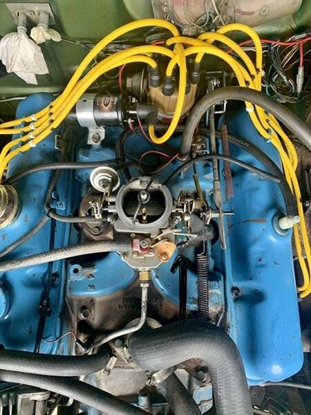

Thanks so much what an explanation! so if the choke doesn’t open with the pedal pushed down what might be wrong I’ll post a pic in a couple minutes when I leave for work. Thanks again
When the engine is cold-
Opening the throttle should cause the choke to close.
Opening the throttle to wide open should physically cause something on the throttle shaft to physically push the 'unloader' tang, which rotates the choke open.
Every carb design is a little different so need to see what's there.
Probably just an adjustment. The choke unloader is different in all carbs. If you look at the choke linkage at full throttle you will see a tang that engages the chole linkage and cracks open the butterfly. You may catch a diagram if you Google it.
It’s hard to see the black arrow but I think that’s what you meant
It just cracks it at full throttle, not nearly fully open maybe that’s how it should be?
Thanks guys I have a lot of great reading material for all night long, I’m thinking 9/64” is probably almost what it was I guess I was thinking for a flooded situation it would open all the way. Thanks all you guys!
That looks like it.
I agree with Mike, I think that's about right. It needs to be open enough so its not restricting.
The factory service manual will have the specifics.
For example this is from the '71 Plymouth FSM
