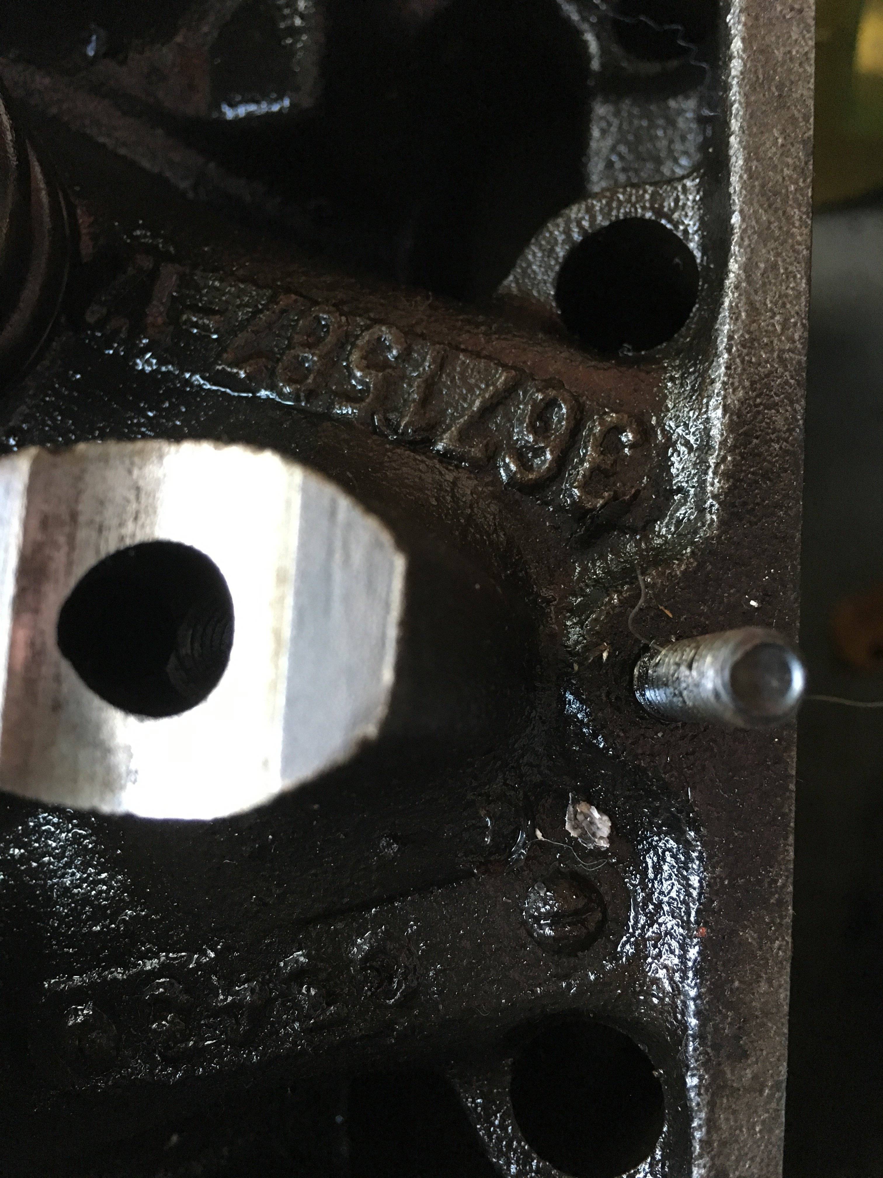

Heads are PN# 3671587 which should be 340 heads with 1.88 1.60 I think?

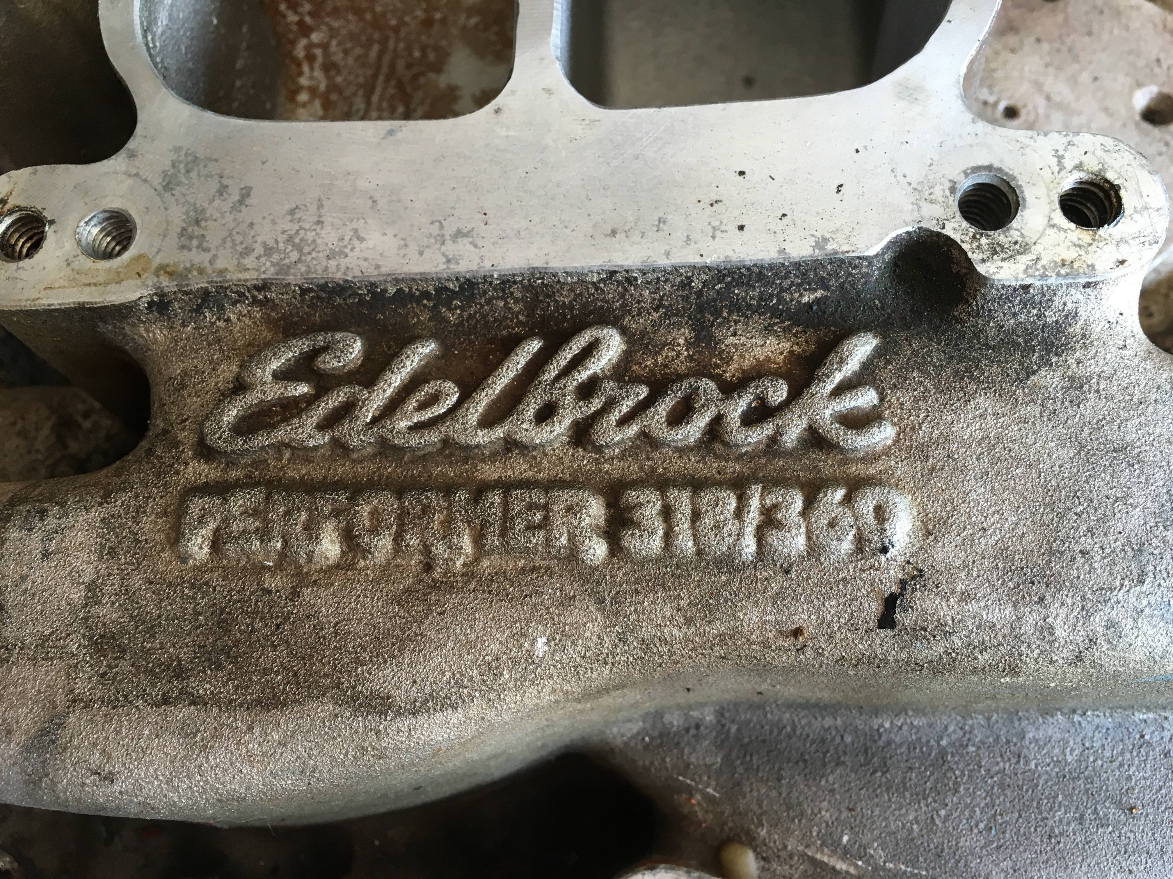

Edelbrock Intake# 318/ 360 #2176

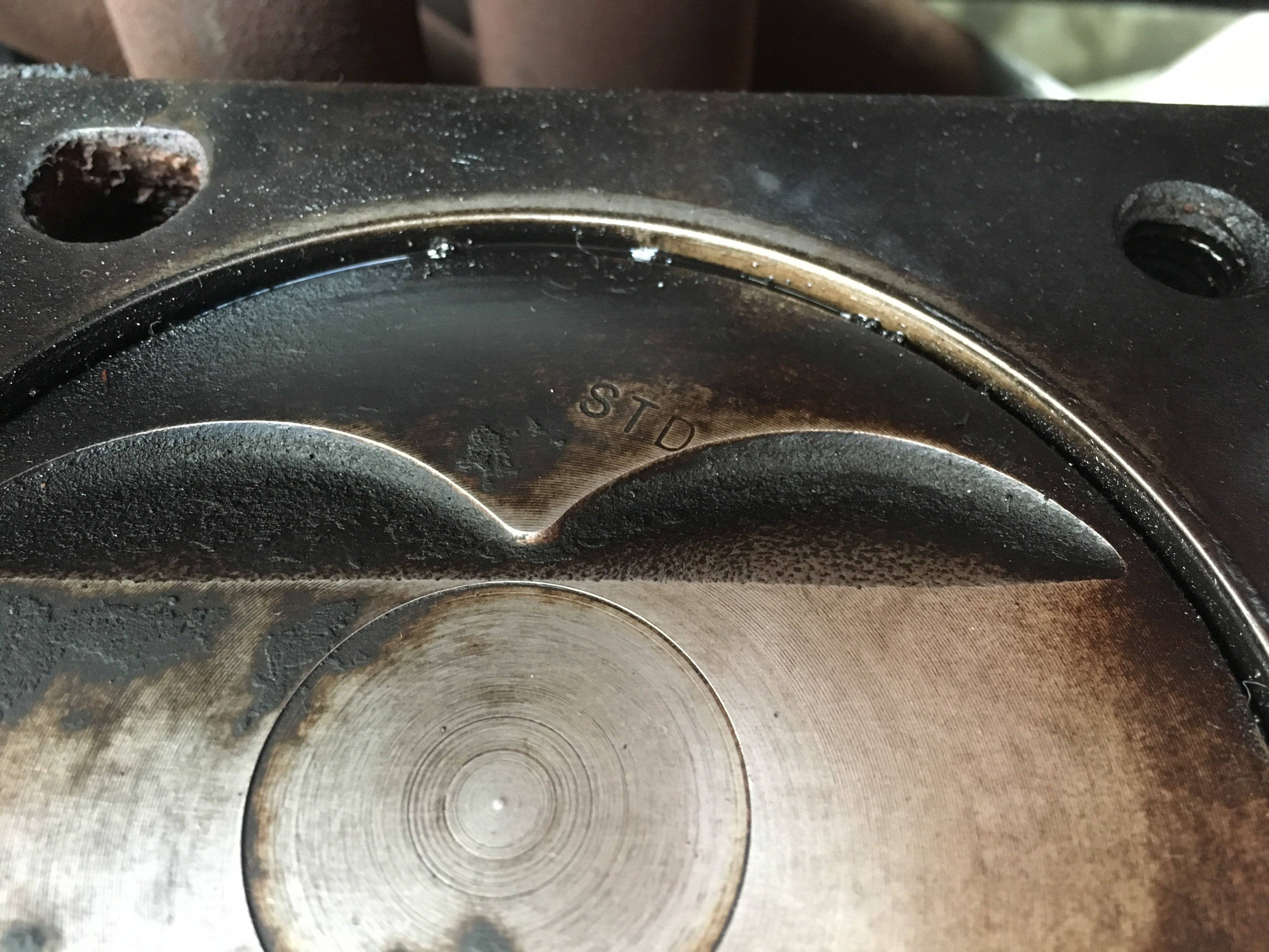

Pistons look to be Standard bore: Stamped "STD"
Looking at the Pistons, looks like there is plenty of room to improve compression. Pistons are down in the hole at lease 1/8th inch.

Those heads with a 1.88 intake valve would not be a 340 head. But that valve size maybe OK for what your doing.

The intake and headers are good; just stick with what you have.

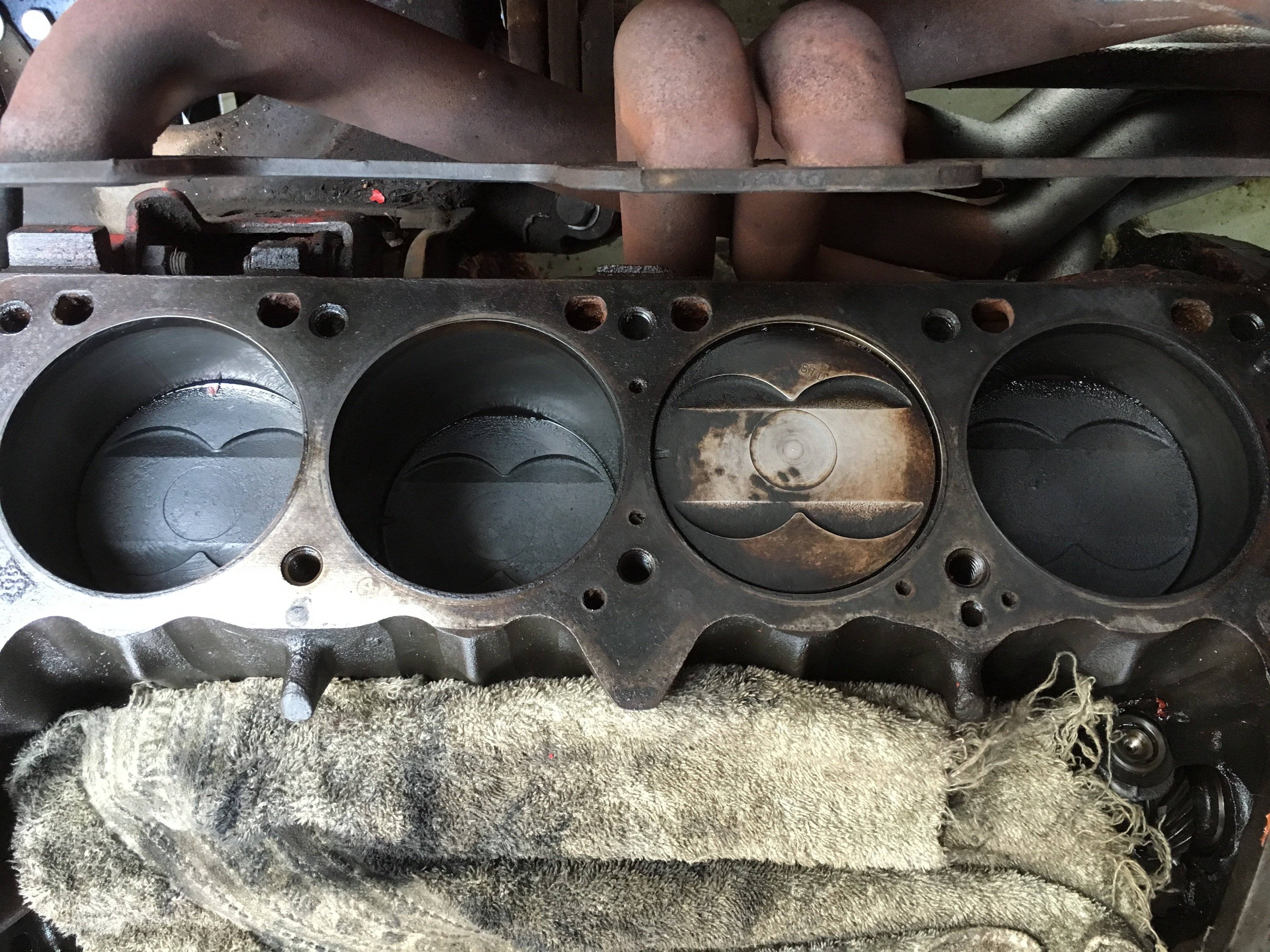

My 340 is a 4.04 bore, still stock bore. I am thinking this engine is not that warn out but just sat for a very long time. There is very little wear anywhere that I can see and this jives with the odometer reading of just 3047 miles. Could this just a low compression 1973 smog motor with old seals and stuck rings? Bought the car from the original owner (85 years young). So considering all this, did the plan change?

Crack her open and have a look.

That looks like a stock '73 340 engine to me.
