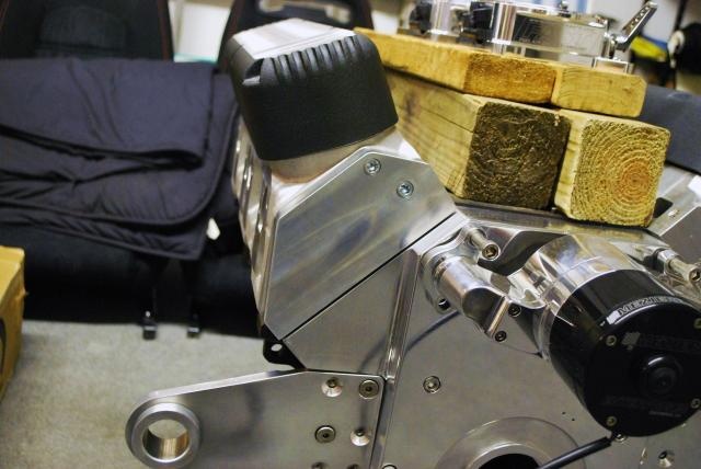

Okay heres an opion question again....This is one of those ideas I had that I'm on the fence about using. I decided to add a lifting point to the heads and incorporate them into the head end plates I made. The first pic is without the hook and the rest are with the lift point(obviously), it still needs polished and the holes need recessed another 1/8" to make the flush but you get the idea. So what do you think with or without ? And yes there will be one one opposite corner(drivers side toward firewall)
