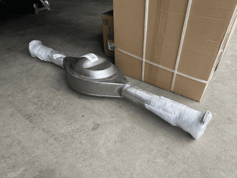

More parts arrived today for my build. Fabricated 9" housing, all the parts needed to assemble a stout aluminum dropout and some 15x8 wheels.
More parts showed up today…. Currie axles, another fabricated 9” housing because the first one they sent was too narrow, rear disc brake kit, carpet kit and a dash pad.
