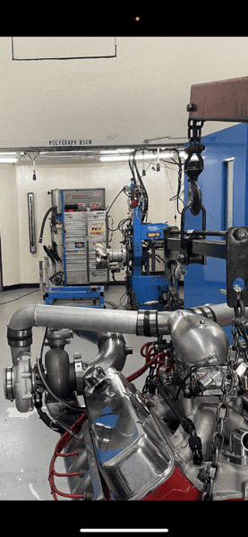

One of my engines is on the dyno there as I type this. I’ll be there in an hour. It is very hard to get repeatable, accurate information from a dyno and it takes the care of the operator to do it. Every time I’ve had my junk on the pump there they scrutinized the littlest of details to make sure the dyno is accurate.
