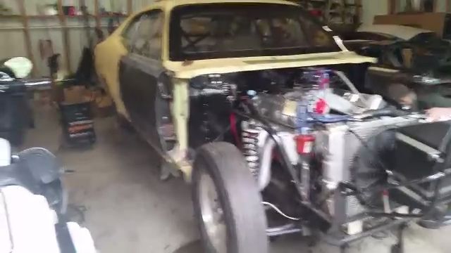

finally fired the old girl up ..been a long time coming and the video don t do the old girl any justice as far as how it sounds...not long hope to have it out for a few test passes make sure it goes straight and don't do anything crazy.....a few of the injection lines are bad so have to replace 2 or 3 of them oil pressure is fine temp is great with the alky ....I was so happy to hear it fire ....:prayer::prayer::prayer:

Methanol sure is cool! Ron's injection? Big radiator you got there. Nice ride!
Yes it's a rons toilet set up..the radiator it's not really that big I had it already so we used it..and thanks guys for the kind words been a long road and still trying to make it. ..just hoping that there is no problems any time ..timing is set at 34 to get it going so probably going to have to play with it some...hope it makes a great pass and put down a good number when it goes out..
Maybe its just me. That rear axle been moved forward 4-5 inches? One problem you won't have,fouled plugs.

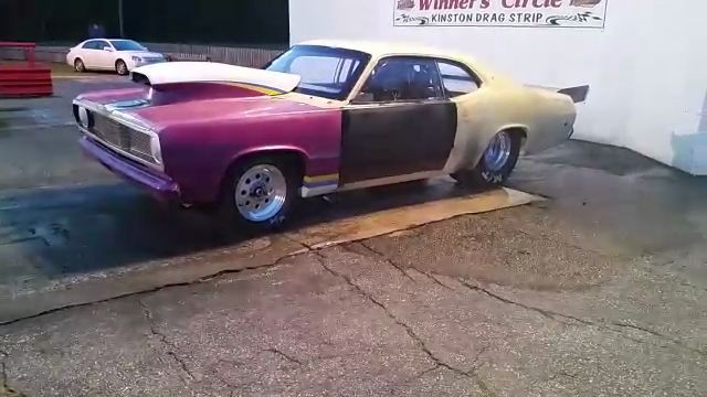

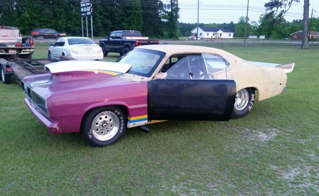

Trying to upload a sound clip from the track ..will post it later ..but this is how it looks right now..paint is in the future but going to work all the bugs out first..
I'm sure I could tune it for some 11's..... that seems to be my luck anyways! :)
Well that's better then the luck I'm having. .lol not knowing anything about alky and how to tune it or anything I believe I have filled a few cylinders and got 4 rod bearing showing somewear really bad ...but I do believe my oberg filter saved me a lot..not a piece of metal up top all in the pan and filter.. but it's a part and on the stand now so got my fingers crossed...we did manage to leave on the car 1 time lol 1.50 60ft and it was like it was on ice for about 80ft or more out....gotta call rons injection tomorrow to see what we need in this thing..we have 93 pill in bypass and 39 in nozzles. .Bob said I need a bigger pill and I think so as well. .but we will see how things go ...now my son has to put his fire suit on the back burner for bearings and gaskets and whatever else comes up ..
injected on methanol. Really is a great combo. But your going to have to rethink some things. Like a bigger pill will lean it out. Not knowing what went wrong I can't offer my opinion. But I will ask, did it milk up the oil? Did it warm up? What temp on the line? At the stripe? On initial startup,did it take a long time to build heat? You can easily burn 1gallon of fuel just warming up. Next time lean it out with the fuel shutoff. Saves fuel and wear and tear. Did you crack the throttle when turning it over to start it? Like you would with a Carb. Foot off the throttle when starting. No throttle until the engine is idling. Contact ron's. They will probably suggest sending in the entire system for a check up. And you need to know what your fuel pump flows. Your tune will be based off your pump. What kind of plug you run? How did it look? You wont foul a plug with methanol. So you got to read them differently. A good plug is ngk r5671a-10. Goggle "reading plugs 101" by Mike canter. Hey,your setup is a good one and will put a huge grin on your face. Just got to adjust some thinking there. And if you knew this stuff already,forgive my enthusiasum. Just trying to help.

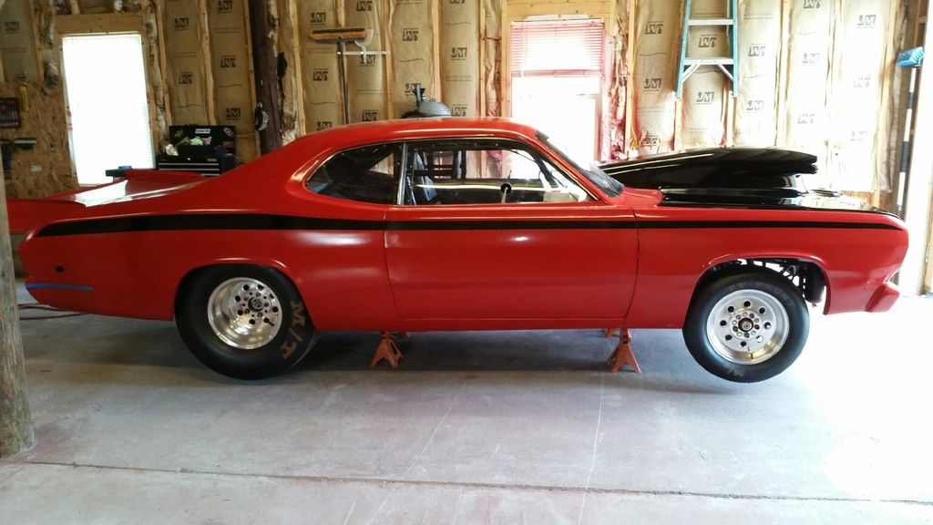

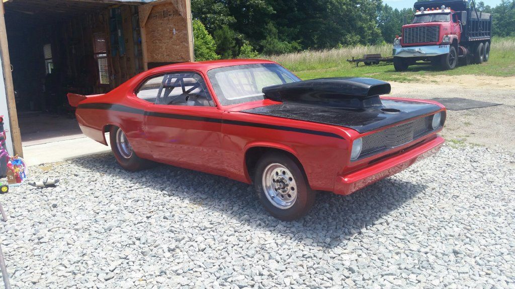

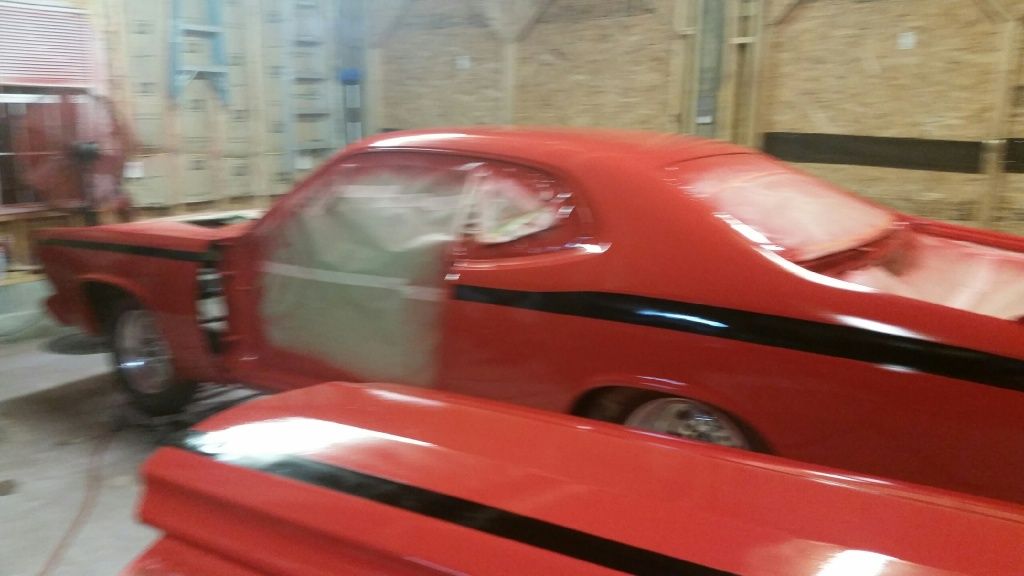

well the old girl has a new look ...I did all the paint work and the lay out of the stripe myself ...never painted a car before so I think it turned out pretty good...I need to wet sand and buff it paint the back bumper and redo the hood got trash in it from being to close to the wall..what you guys think looks pretty good ...
Some of the best paint jobs come from garages; yours supports that theory!
Way to go sir!
