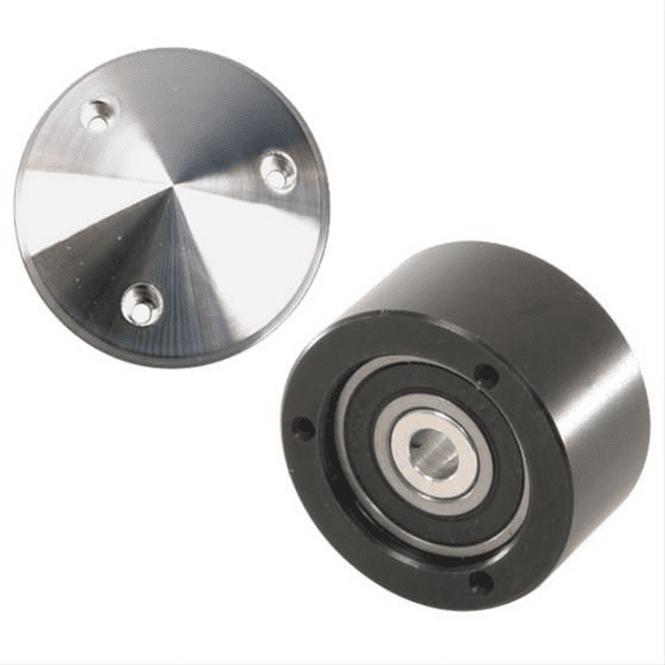

I have used these generic ones from March in the past. They use commonly available bearing and come in clear, black or chrome finish.

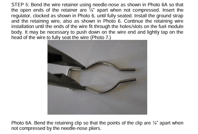

There is a pressure release valve in the basket that can (should?) be swapped for a regulator. The stock application uses PWM for pressure control and the valve is just in case something goes wrong. By switching that to a regulator, no external regulator is required.
But you need this piece:
And a Gen 4 Camaro or a '96-99 C1500 FPR:
Note that there are cheaper options for the truck one. Those are just the P/N's suggested by VaporWorx (who is now owned by Aeromotive, BTW).
And you have to tweak the retainer as the FPR is slightly smaller:
