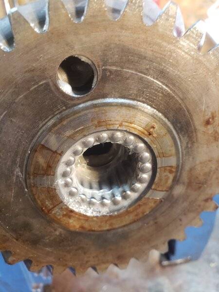

What's wrong with this picture? Answer the metal ring is missing. I bet you put it next to the spacer-tube...... that's not where it goes,lol. The outboard rings (one on each end) are there to protect the washers. The rollers will ride on the ends of the spacer-tube just fine. When you get it out, look at the ends of the tube; they will be all polished.
I would be calling Jamie passion first thing in the morning and asking him what the hell's going on and how to fix it...
With that said I bought mine from Brewers performance and they sent a piece of PCV as well...
It's not missing... it was laying on the bench while I took the pic, hence the lil gap at the end.
Anyway Why are we talking about the Cluster (That's Already in?)
And that Pic was of the First Side of the Cluster... I still had not gone around and finished up on the other side and centered everything.
Okay now I'm starting to get a grasp it's just the fourth gear input shaft bearings...
Of course it's not going to push in from the top it's going to slide in front to back....

Thanks for This! I even tried mixing them up. I marked all 8 of the old ones and put them in every-other-one... Didn't Fit!
Now they're all out again and separated. The New Ones from Passon's Will Not Fit.
Cuz you posted the pic? and I saw the missing washer? and I wanted you to not have a disaster on your hands in a few weeks?
Hey I'm just looking out for ya.
Thank You Sir, I was just pointing out (with a pic) how easy it was to drop them in despite not going in from the outside like someone here keeps saying...

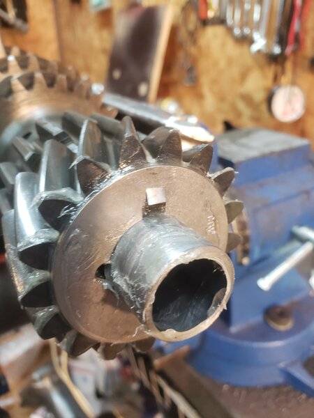

I see the input laying in there, and it seems to be a lil crooked so I assume the bearing is not on it yet. But it's kindof hard to tell , so I won't put my foot in my mouth a second time...
what's your plan for this?
Well if I angle my screen just right, the bearing does seem to be on there.......
It's all Snap-Ringed in now... Both Halves. wanted to assemble tonite, then I ran into the needle bearing hiccup.

Yeah but you've put a lot of these together and never run into this so what is different here?
Rollers are probably ok unless Jamie got some out of spec parts.
ID of input shaft?
I would not mix old with new as larger ones would be taking the load and smaller ones would not be doing anything except acting as spacers. I looked at my old ones and there really is no discernible difference when compared to my new Passon parts. AJ says use the old ones so that may be where you are going.
