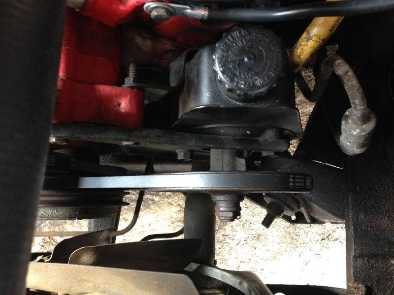

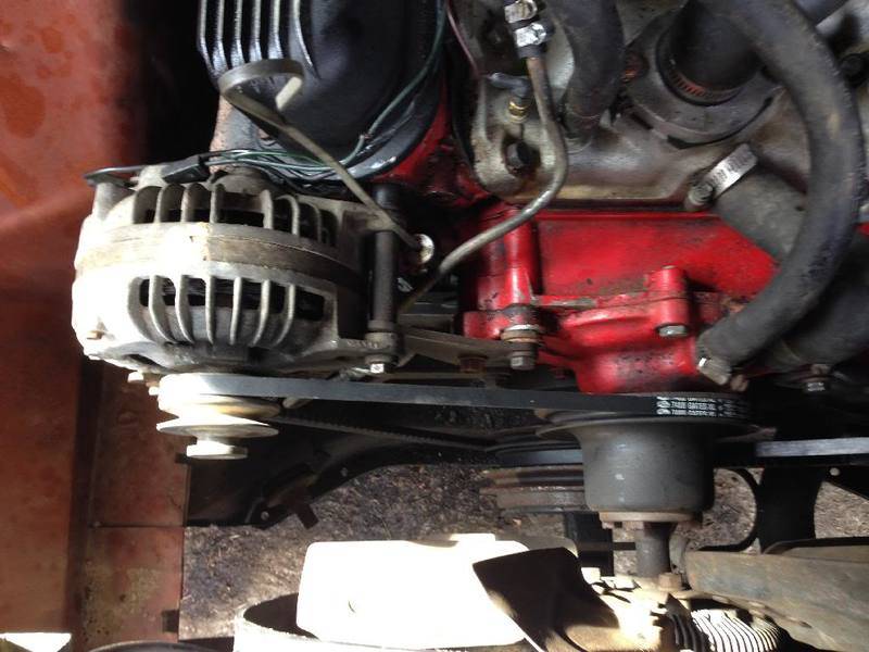

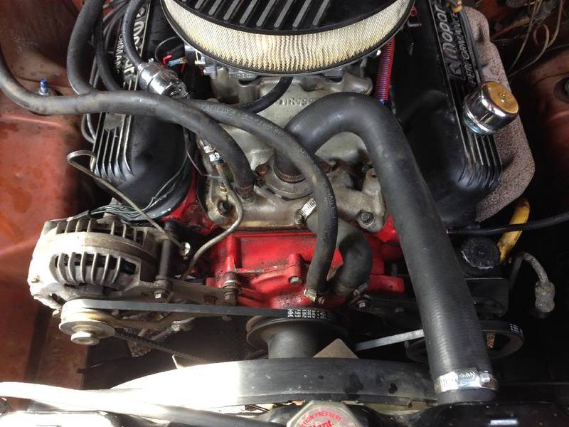

Finally got the AC system off of my Dart. This is what it ended up looking like. All we did was get some spacers for the alternator mounting bracket. The previous owner had apparently already installed shorter belts.
do you know the part number for the power steering belt

sorry the engine is a 74 360 i think it was out of a challenger, it had ac but i removed everything put non ac single pulley alternator and non ac water pump pulley and non ac crank pulley. my power steering pump is in the exact location yours is in from what it looks like, that's why i was asking about the power steering belt.
I removed all of my under hood A/C components many years ago.
I bought (from ebay) another rear compressor/alternator bracket and did some cutting. I then purchased a small block Chevy chrome alternator adjustment arm (~$10 at O'Reilleys) and cut it to use for the alternator pivot point. I use a second PS (Federal pump) belt which connects the alternator to the crank (with a little grinding of a rib on the water pump). Been like this for several years, and several thousand miles with no troubles. All in about $50. Cheap and easy, and I still have all the original parts if i ever want to go back.
