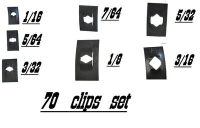

As mentioned, try using barrel clips which is kind of an insert that the emblem pushes into and expands to hold it on. they look like this and can be had at most part stores for a couple bucks.

Hey thanks John, thats it! My heads spinnin with all the mopar stuff....

How about these with a dab of JB Weld after they are on?
Yep I would think they should work with the BJ weld

I guess easy to tell would be to put the panel on with a couple nuts, or hold it on, and push the emblem through with nothing there and see if it goes in all the way or bottoms out? those clips you posted last would like work fine JB wouldn't be necessary with those. They do hold pretty firm.
Those clips are not easy to get off when you want them off and no one is just
going to pop the emblem off at a car show either.

I like that idea better than slicing the pin in the middle and bending the tabs over.
Might have to try to put them on in reverse if the pin doesn't stick though very much.
