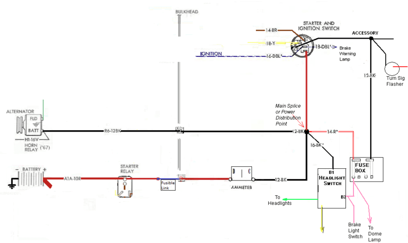

The ammeter is a part of the battery power feed. There are two different colors used so the ammeter reads correctly.
When the wires are connected, black is hot, just like the red is hot.
The black wire is connected to the MAIN JUNCTION. This is a WELDED SPLICE.
Everything connected to the welded splice is hot.
The splice joins the two power sources, battery and alternator, with the dircuits that feed everything else.
When the key is off, half of the fuses are off.
With the key off, there should still be power at the fuses for the dome light, brake lights, tailights. There should also be power for the headlights (no fuse - circuit breaker inside the headlight switch).
If none of them have power, then the break is in the circuitry before where they all join. Right?
The cable routing and hookups on a '69 Valiant should be lke this.
Note the ammeter red wire comnnection is labeled red.
Items noted as E Series is wiring for model year 1969.

"No power at all" is pretty limited. Battery wiring to starter relay stud, fuse link, "big red" through the bulkhead connector terminals, continue on to ammeter, and black leading out of ammeter. That black splits off a few inches down (wrapped up) at the "welded splice" and branches off to headlights, to ignition switch, to fuse panel "hot buss" and on out through bulhead (big black) to alternator output stud

Doubt it very much. It is much more likely "No Power" is more likely in the vicinity of what I posted last......the main basic power distro Go back and look at post 23---that diagram

Then he may have but THAT IS NOT THE CAUSE of you not having power. Take a "working car" Let's remove the cluster............Unhook battery.........remove ammeter gauge wires and BOLT THEM TOGETHER AND TAPE THEM. Now, with the cluster completely removed, the car will start and run normally.
So what changed? As I said it's in the diagram I referenced. Follow along for about the third time:
Power comes off the battery and to the BIG STUD on the starter relay which is one of the relay contacts and also a junction point. From there power goes through the FUSE LINK (RED) and to and through the BULKHEAD CONNECTOR. From there it goes inside the passenger compartment and connects to the AMMETER (RED)
So check that far: Power at the starter relay stud? Power at the BIG RED wire cavity in the bulkhead connector? Power at the BIG RED wire at the ammeter? You are losing it in that area somewhere "I bet"
