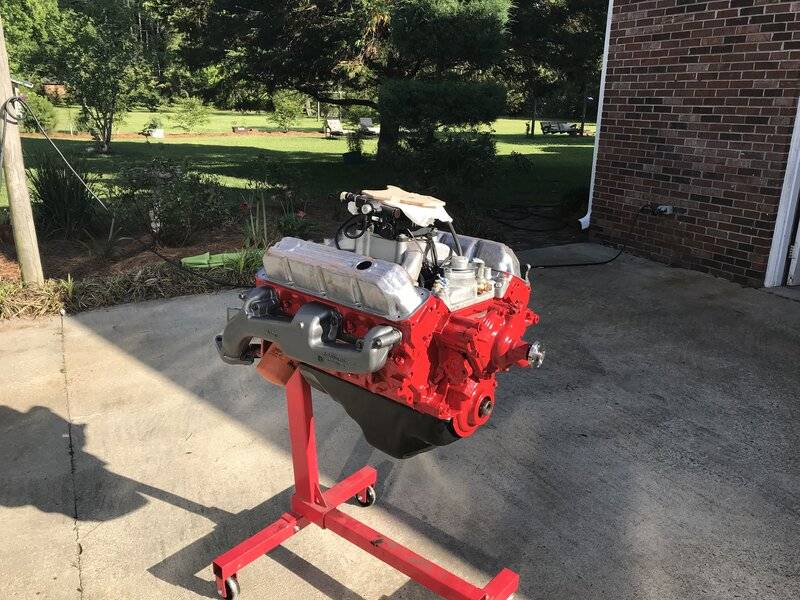

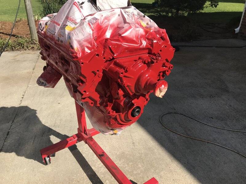

Now that I got the plugs issue straightened out, I am going to doll this teener up like a 69 340. I bought duplicolor chrysler blue enamel, but it's got that ceramic in it, and doesnt really shine on the samples I painted, and appears to be the wrong color. I decided to go with VHT engine enamel, however weren't the early 340s the turquoise green? Car is going to be red, I dont want the engine to be red too. Detroit diesel green appears as a close match to Chrysler turquoise. Anybody here have a better idea than using the detroit diesel green? I can get it at oreillys right here.
Look at Eastwood’s paints. They have cut back on some colors but the last time I looked (probably 2 years ago) they still had that color.
Its a bit pricey but it’s quality paint.
EDIT: I just looked. They discontinued that color. It sucks because they have 2 different Pontiac colors and not Chrysler blue.
I was out looking at some rattle can crap and couldn’t find Chrysler Blue at any of the big chain stores.

Mancini racing has their own labeled Blue. $60 a case of 6.
The MoPar paints are semi in stock. No Blue, Red or Argent. I am going to be looking for the Argent now. I want to re so my sons steel wheels. What ever Argent paint is in there now is pretty weather beaten. OK I guess for a ‘91 truck that worked.

I went with Red on mine from Duplicolor, Code is DE1653.
