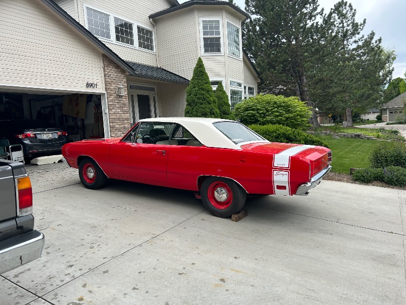

It really depends on your engine build and intended use . If you have a big cam and want to street drive it the tall 1st gear of the close ratio trany will make it jumpy at low speeds . I run a 2.67 1st gear in my 69 Swinger with a 408 and 246/250 - 108 -.648 lift cam . With 3.55s I can feel the pulses from 900-1300ish rpms . I have an early 833 with a 3.09 1st but it’s a trunion trany . So my plans are to swap the current main shaft to the existing trany . That way I get the 1st gear driveability and can do freeway speeds at a reasonable rpm . Remember … getting the car moving from a standstill and 4th gear pulls require the most power . So best of all worlds! If my car was a dedicated drag or autocross car the close ratio would be a better choice.
