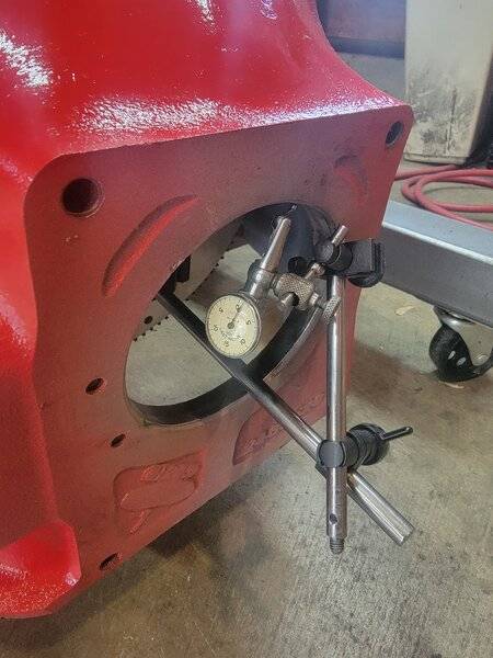

How will you Dial-In the BellHousing with the Clutch already in place?

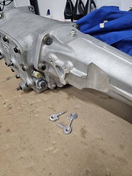

Today I test fit the transmission without clutch installed. The purpose for today's effort was to establish total installed length, in order to get a driveshaft ordered. I found the B body shifter mounting bosses (which I don't use or need), are interfering with the upper transmission cross member. I have removed the transmission and will proceed to grind these bosses down, I will verify this with Gear Vendors tomorrow before I proceed.

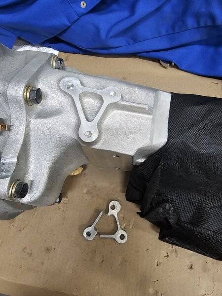

As for that front boss, I didn't need it anyway and was pretty sure the GV was gonna stay in my car forever, so I sliced it off and prettied it up a lil.
I used the rear mount, and also moved the entire shifter some 7 inches back between the buckets, and over to my thigh. I haven't missed a shift in the 20 years since.
Didn't accomplish as much as I would have liked today, got the B body casting for the shifter mount ground down about 3/8". A quick call to GV this morning to make sure I didn't void my warranty or anything. They assured me it would be fine as the adapter is a very robust casting.

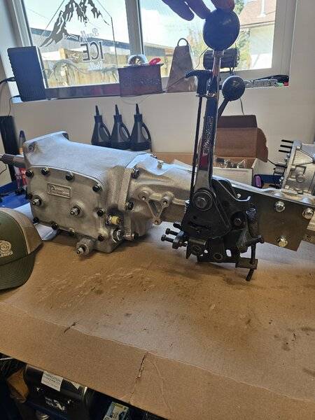

In my case, it might be a blessing actually, but in general terms I agree with you. I am likely going to install a Hurst Ramrod shifter, the bracket will provide me the freedom to locate the shifter exactly where I want, and reduce the need to cut the floor up. I am pretty certain I can make it fit through factory floor hole.
By far my favorite shifter. It’s inline but it’s not a Vertigate.
Hurst pooped the bed when they quit making that and started doing the vertigate.

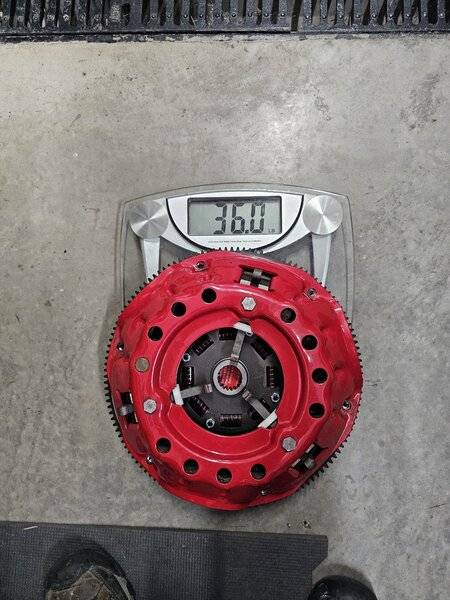

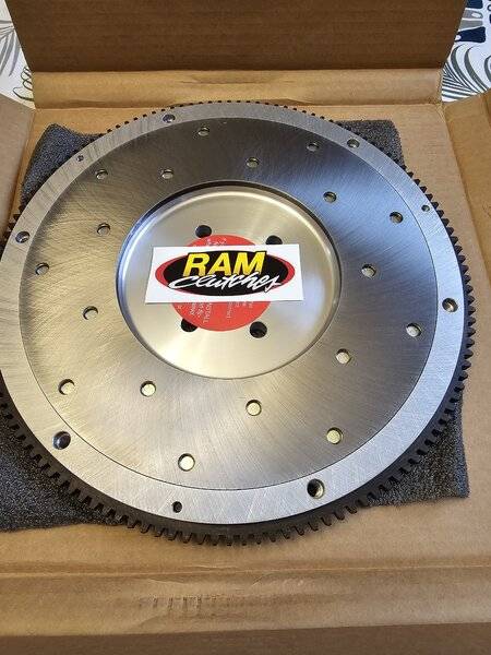

So the new aluminum flywheel arrived, I will be away until Thurday evening for work, then I can begin to reassemble. For those interested, a Ram 1503 flywheel and clutch assembly weighs 51.9lbs, the 1503LW lightweight steel flywheel and clutch weighs 43.8lbs and the Ram 2503 aluminum flywheel and clutch weighs 36.0lbs. This should change the rate of acceleration, I would think.
View attachment 1716317859View attachment 1716317860
Now I have to weigh my junk. The cast iron pressure ring in these covers adds some excess weight so that has to be taken into consideration.

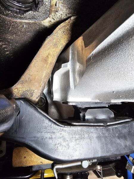

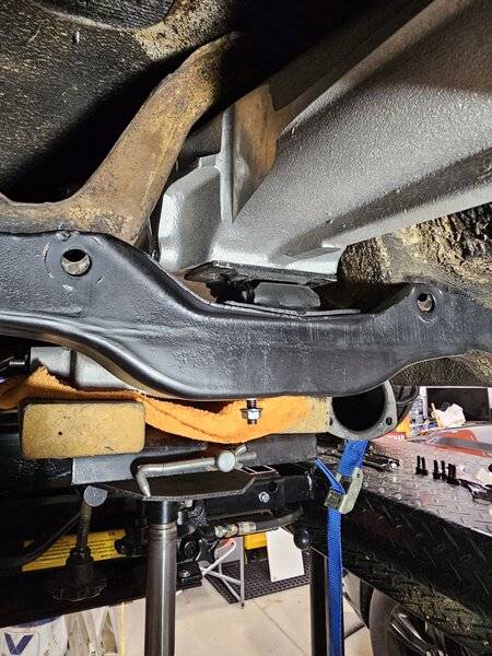

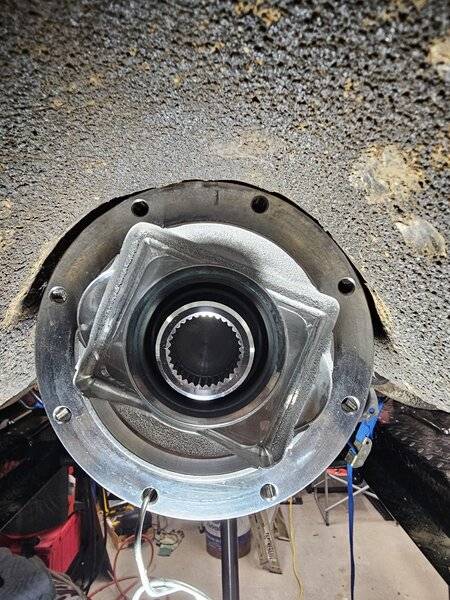

Huge delay in progress, but I am now back at it. After grinding the shifter boss off, I am still making contact to upper crossmember with the top side of the Gear Vendors adapter. Did anyone have to grind on the adapter housing itself, in area other than the boss?
The GV is touching in 2 places, where the upper side of adapter housing is touching under side of upper transmission crossmember, and the flange in the tunnel where the actual auxiliary unit bolts to adapter housing.

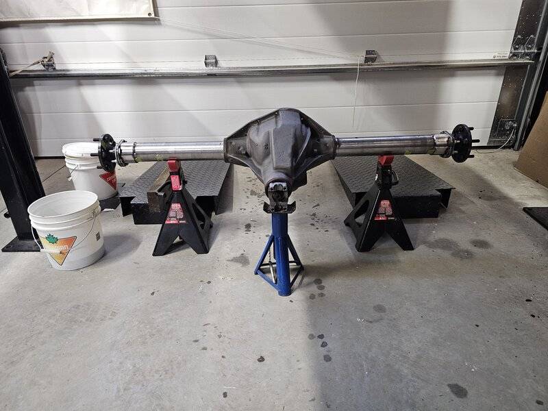

Question, since I am installing a new Dana 60 at same time, can I mount the Gear Vendors where it fits properly, then make all the adjustments for pinion angle by adjusting the axle in the perches, before welding them?
View attachment 1716378604View attachment 1716378605View attachment 1716378606
Yes to pinion angle. IDK on the other. I’ve never installed one.
weld rule 01.....do not weld ANYTHING (tacs only) until EVERYTHING is where you want it.
driveline angle tip......it is critical that the total degrees of the transmission / driveshaft angle is equal or matches the total degrees of the pinion / driveshaft angle. There are several good U-tube videos on it relating to vibration elimination.
I am thinking of cutting the bottom of the crossmember from the mounting holes, then add some metal in and weld back together. My initial thought is to make the removable portion of the rear transmission crossmember 1/3-1/2" deeper than stock, allowing the tail to sit slightly lower. Although this amount may prove to be to much, I can shim the tail back up if needed.
I realize this will induce some angle to my clutch linkage and exhaust, I don't actually need to move it 1/2", just want to cut and weld once.
I have clearanced the floor slightly already, hesitant to keep moving upwards, would like to split the difference of needed clearance downward if possible.
Again, I plan to set pinion angle with diff prior to welding perches on.
Thoughts?
Thoughts?
Is there room on the top side of that upper crossmember to notch it? Looks like a 1" to 1 1/2" piece of 90 degree angle notched into that upper member would give you the clearance you need? I thought I've seen that type of mod before but I may be mis-remembering. I'd rather make room in the floor pan and upper mount than have it hanging lower or at unfavorable angle. All that stuff is hidden or under the carpet.
I guess my tunnel was a lil deeper, or my BFH a lil heavier. lol.
Also, I was using a 73up polyurethane spool mount and x-member. I slotted the saddle, and I slotted the mounting holes just a lil.
My engine mounts are the 72down style, so I think my engine sits a lil lower than with the spool mounts.
I cannot remember trimming the GV anywhere, so I probably didn't

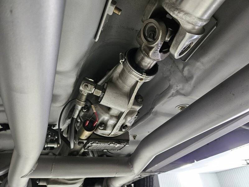

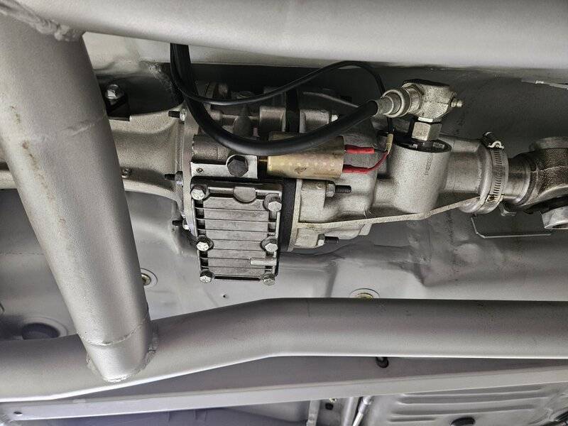

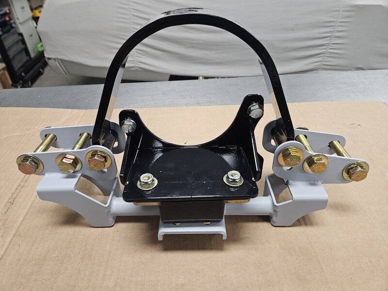

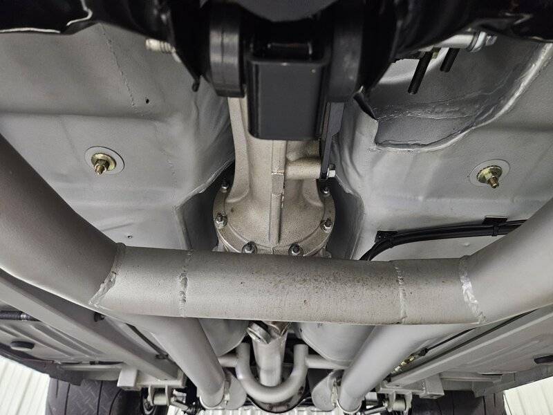

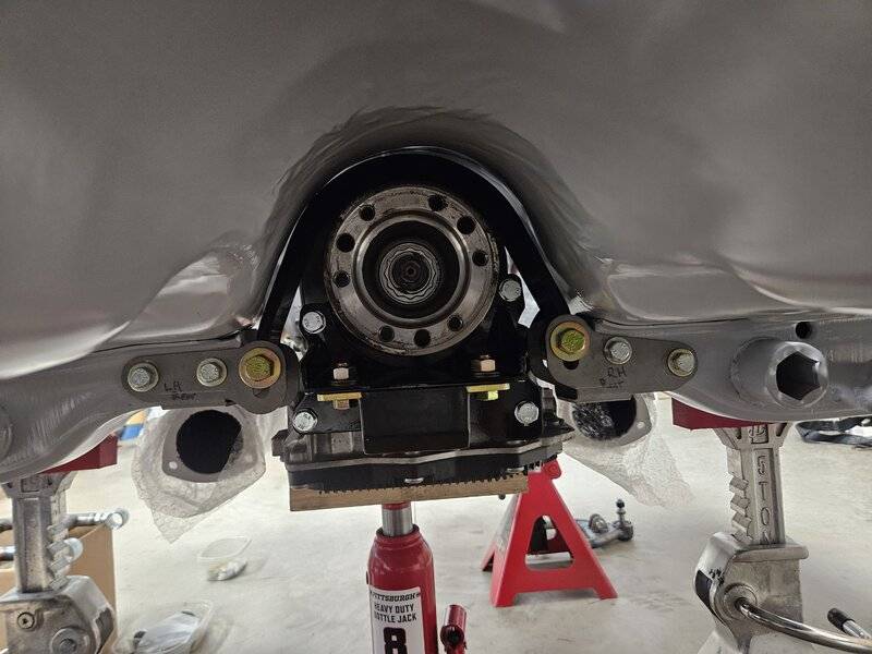

I build this transmission mount for the Gen III / 8HP70 8-speed trans. I allows mucho more room in the OEM crossmember area
Maybe it would have a use (without the 8HP mount) in a GV application....????
