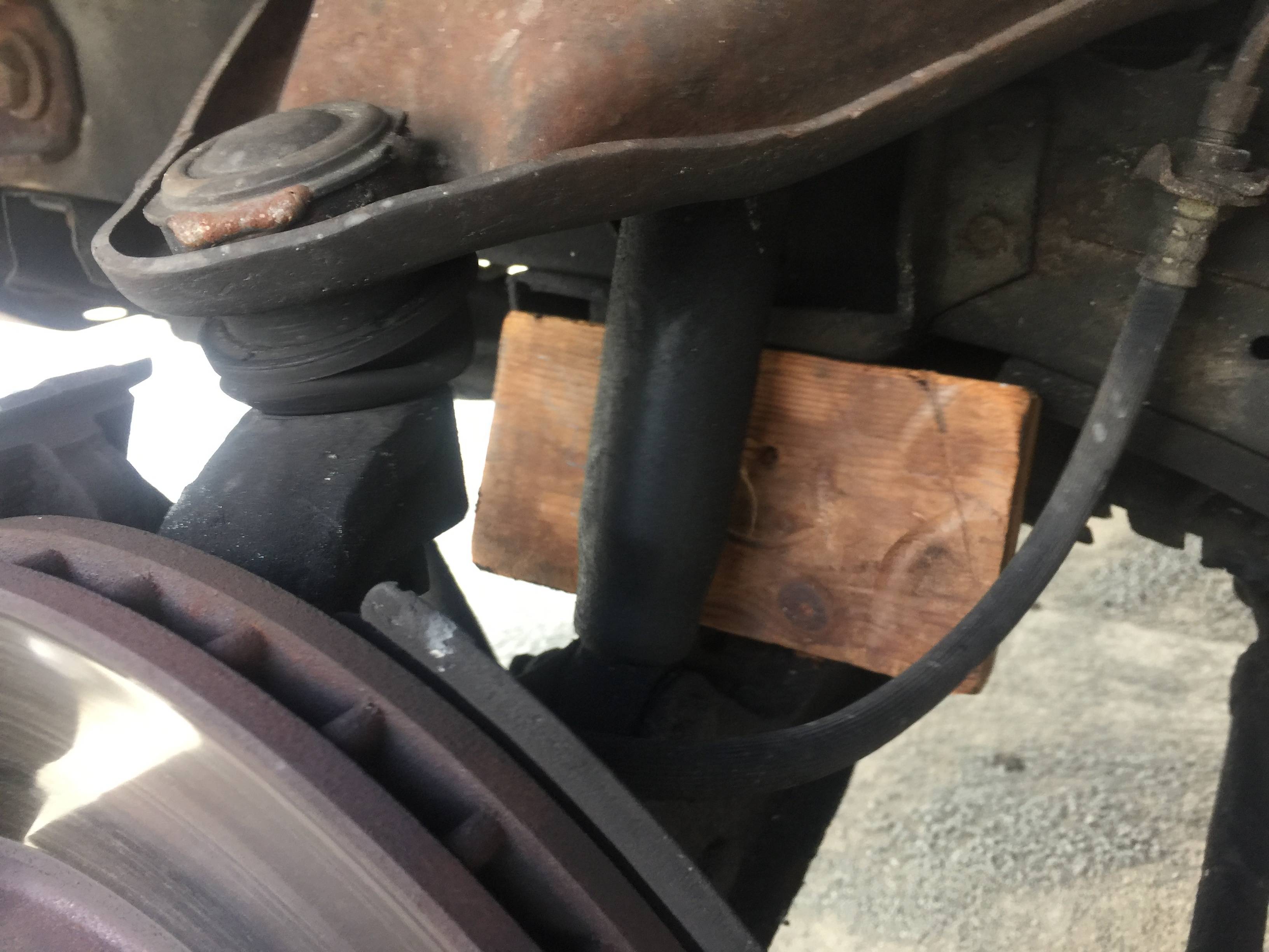

I can't believe you drove that car with a broken torsion bar.
With getting there and back to my parents house, about 100 miles. If I can't find another today, I'm going about another 130 miles on it. Not much of a choice, it has to be done, I have to get her back home.
Get a chunk of 2x4 between the lower control arm and frame section, and you'll be thevonly one who knows.
It will sit straight.

Can't get a torsion bar up in Ocala, but sourced one back home. Here's the temp fix to get the 130 miles home.
I'd be happier seeing it sit on the flat side of the 2 x 4 that looks like it will want to flop over and drop down.
If that's the level you need, get a 4x4, or nail 2 2x4 srction sections together!
Please!
I would expect it to sit way high with that much spacing.
2 inches was always just perfect when I had to do this.
Please!
It's jammed in there pretty good and the car is sitting level again. That's the only piece of scrap wood I could find that would work. A 4x4 or that laying on its side wouldn't clear the between the shock and frame. I am thinking about putting a ratchet strap around it now though.

I put a strap around it and it is solid. I'll do what I can, but it's 130 miles down I75 with two construction zones. Being she doesn't want to go much over 60 for some reason, I'll be in the slow lane the whole way. Planning on leaving tomorrow morning so I have most of the day to fix it right.
Do not drive that far without torsion bar. The bar is not only act as spring but also act as a lock to keep Lower Control Arm in place. Without the bar, and driving that far, the strut might bent and Lower Control can came off, even the pivot nut is tight (only rubber bushing that hold the LCA to frame right now)
Do yourself a favor, get it tow or install new torsion bar before you drive that far.
I would tow it, but that's $400 I don't have. Nobody around here has one and I need to be back in town tomorrow. I was able to contact a friend of mine and he said it'll be fine and it won't damage anything. I trust him since he's been working on these cars since they were new. I've already run her over 100 miles getting to the show and back to Ocala. I'm not going to be going fast and I'll avoid all I can, she should make it home.
He's right!
It DOES stress the lower control arm bushing.
I would rather see you limp down two-laners than put it on an interstate, where even small bumps will become lots of liading on that bushing.
Well, the trip home totaled 137 miles. I never went over 60 and she made it home no problem. I've sourced a pair of torsion bars for $60 and I'll have them Saturday.
