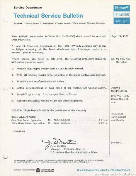

Yeah they all look a little different. I’ve seen some with lots of extra material there and some with very little at all, both clearly being unmodified. I don’t think Ma mopar was too worried about exactly how much of that mounting tab was folded over and welded. At least not until they issued a TSB about them cracking. There’s a factory fix/gusset that was prescribed for cars that developed cracks in that area.

Here's the TSB info on that showing the gusset, it's over at hamtramck-historical. The links will show the full size version. This shows the issue on the opposite side from what is usually needing clearance for the narrow "V" shaped uca's, but it would work for both sides and you can imagine that cutting the mount back too severely could cause cracking at the other side.

I’ve seen and repaired cracked on both my 68 Dart and 68 Barracuda. Back in the 90’s when I’d see Abodies in the junkyards I’d see many other cracked ones
clean and wire brush this area on your A-body and you might see a small crack.

Wow thanks for the information I really appreciate the input. The last thing I want to do is to hack up my front end.
