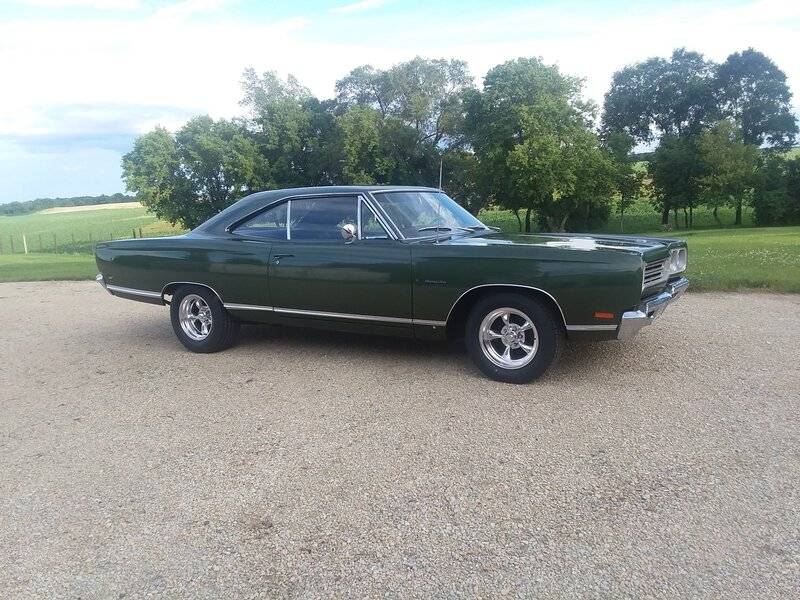

2.94 gears are my favorite gear sets with the 741 case > for cruising and at today's highway speeds.
Stock '69 318 with added Edelbrock 1406 4 barrel, 727 trans and the 2.94 gears.
Pass anything you want, the light weight Torq Thrust II aluminum wheels helped performance a lot. Less rotating mass to spin up.
